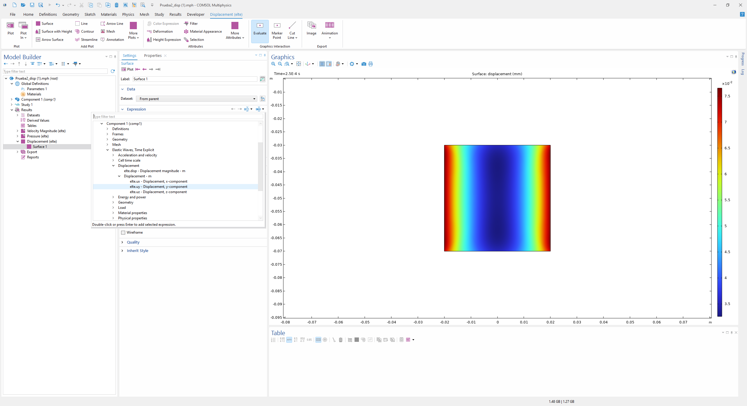

Hi. Is there any way to compute and plot only the y displacement (axial) instead of the absolute displacement and export the data in the Displacement plot?

Hello Sergio,
If you look through the list of available expressions available for postprocessing in your Surface plot, you'll see one called elte.uy that seems to be the one you are looking for.
Hello Sergio, If you look through the list of available expressions available for postprocessing in your Surface plot, you'll see one called elte.uy that seems to be the one you are looking for. Best, Jeff

Hello Sergio,
I am referring to displacement. I think “elte.uy” refers to the position, or am I wrong?
>Hello Sergio, > >If you look through the list of available expressions available for postprocessing in your Surface plot, you'll see one called elte.uy that seems to be the one you are looking for. > >Best, > >Jeff I am referring to displacement. I think “elte.uy” refers to the position, or am I wrong?

It's the displacement in the y direction, see the attached file.
It's the displacement in the y direction, see the attached file. Best, Jeff
