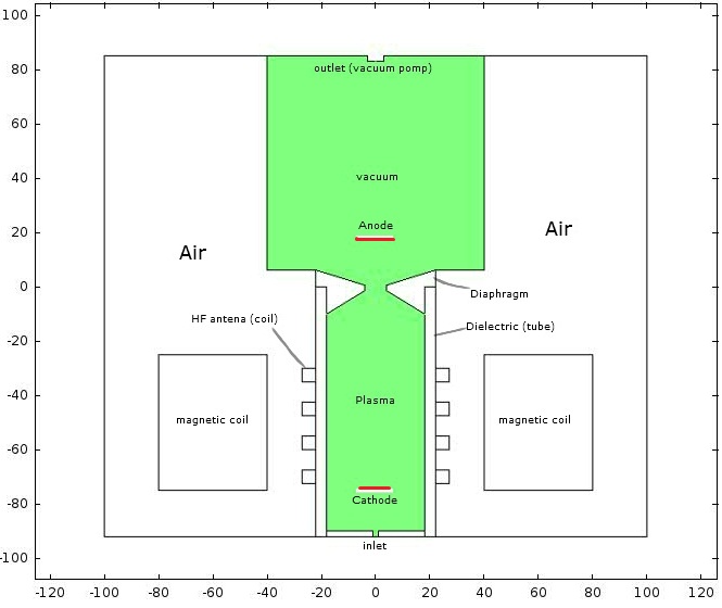

Unfortunately I didn't understand ...! didn't know how to solve this problem! My model consists of Plasma module and Lamir flow. My mass flow rate 1e-7 kg/s.
Inlet thickness 2 mm.

first of all, in 2D-axi you should have no geoemtry on the r<0 side of the axis, only the cut line along the r=0 symmetry axis.
