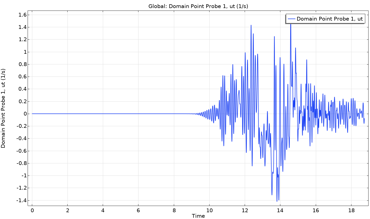

FYI, I ran your model for some of your overall time span. It seemed to execute without complaints. I don't know what this model corresponds to physically, so I have no idea whether it is computing correctly or not. But it didn't generate an error, at least for as long as I executed it. I've attached a plot of your probe variable vs time. Note that non-linear time-domain problems can suffer from all sorts of stability issues, so even if you have everything else set up correctly (and you may not), you may still need to carefully adjust various solver settings and time stepping parameters to obtain physically meaningful results.
