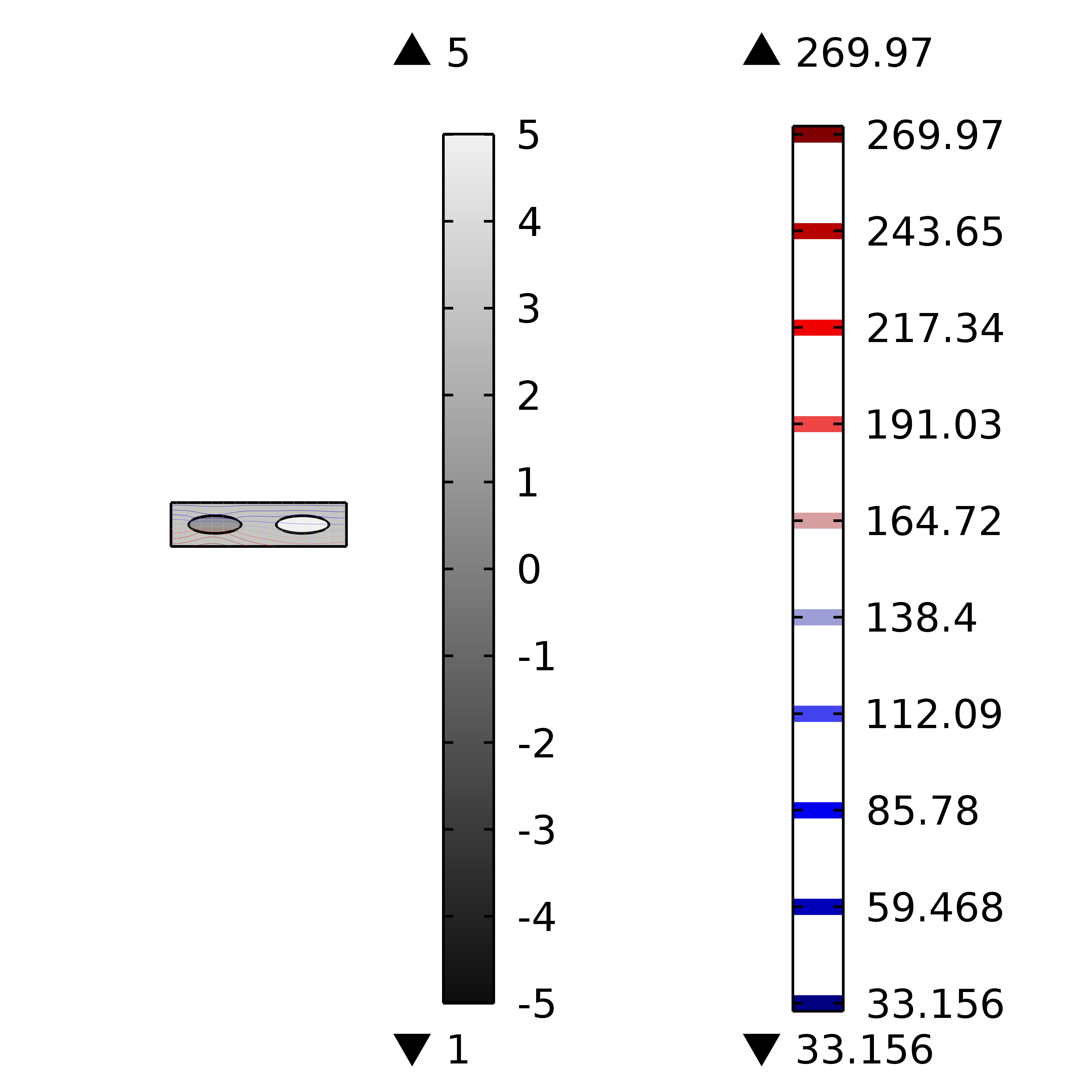

I am using COMSOL 4.2a, and want to use some surface plots alongside legends of the colour tables used. It is bizarre that COMSOL does not provide vector graphics export. I have tried to generate a decent image using the png export (via the 'snapshot' button -- is there any other way?), but it is horrible.
How I am doing it is:
1. Use highest 'Quality' settings in each component of the plot group that has such a setting (e.g. Surface; Contour)
2. Set export resolution to 1200 DPI
3. Set image dimensions to highest possible (for me it seems 4096 pixels is the upper limit?).
4. First generate a snapshot without any includes (i.e. no title, legend, axes. etc)
5. Then generate a snapshot with the legend included.
6. In GIMP cut and paste and scale as required.
See attached file for example of trying to export a surface plot with two colour legends. The model image part of the figure is tiny, and the legends huge.
If anyone has any tips or a separate set of routines in python/matplotlib or similar already in place I would love to see it!

Thank you for your comments and suggestions. In this case I would recommend trying a lower DPI, as this would produce a bigger image (a DPI setting of 1200 and a width of 4096 pixels results in an image just over 3 inches in width). The DPI setting also affects the size of the included extras, a lower DPI setting yields smaller colorbars/legends/etc.
An alternative method that can be useful is to resize the GUI image frame to the desired size before exporting it. In the Image snapshot menu, change the Image size to Current - the image will now be exported using the current size of the Graphics window.

Hello Ben, Thank you for your comments and suggestions. In this case I would recommend trying a lower DPI, as this would produce a bigger image (a DPI setting of 1200 and a width of 4096 pixels results in an image just over 3 inches in width). The DPI setting also affects the size of the included extras, a lower DPI setting yields smaller colorbars/legends/etc. An alternative method that can be useful is to resize the GUI image frame to the desired size before exporting it. In the Image snapshot menu, change the Image size to Current - the image will now be exported using the current size of the Graphics window. Best regards, Anders Ekerot COMSOL
