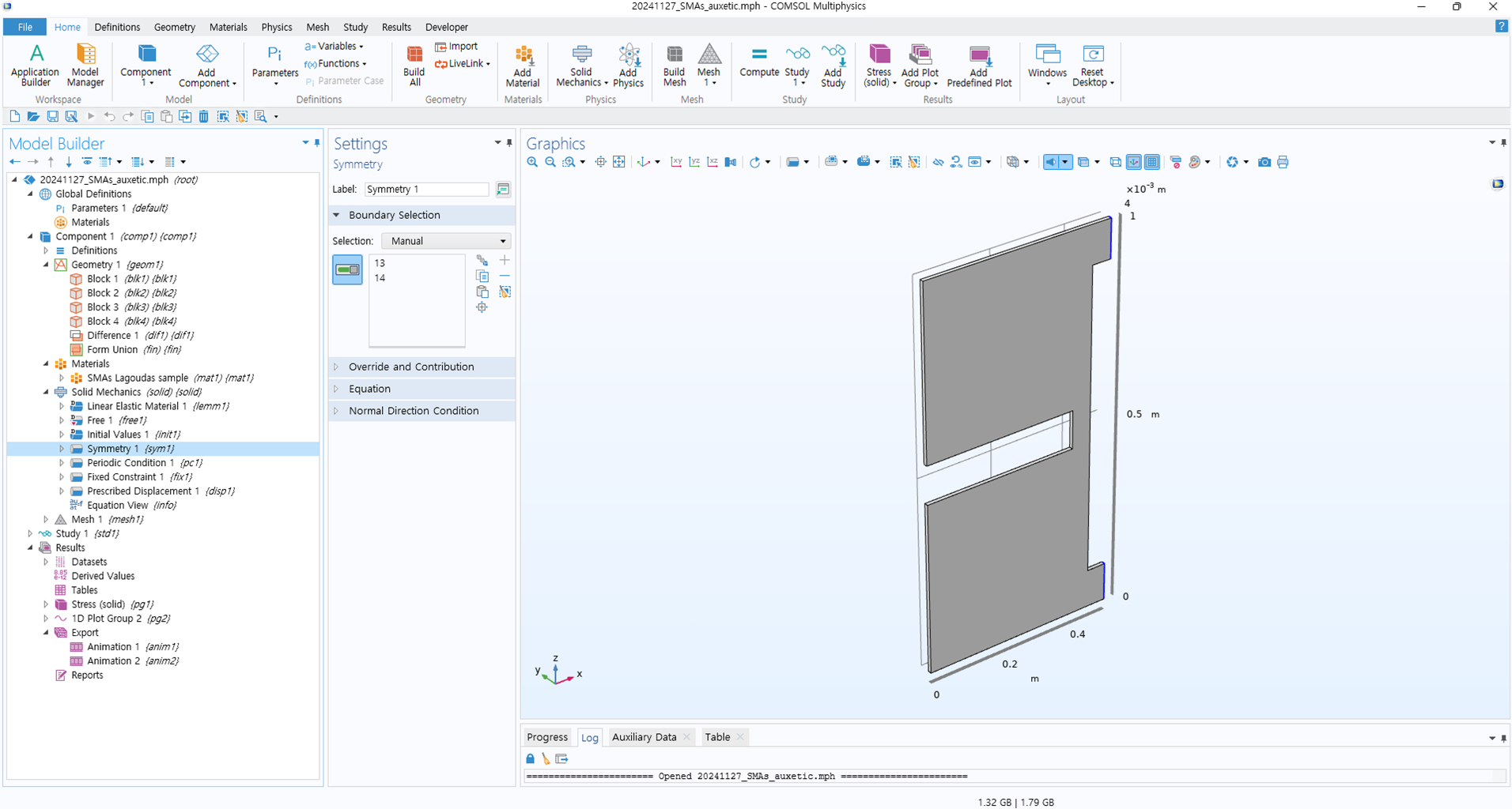

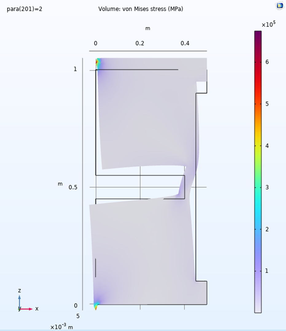

I am working with model having symmetric geometry. So, I want to utilize the symmetry node in simulation. However, when I receive the results, I think there is no symmetry in my model !
Please let's me know the reason and where I did wrong step.

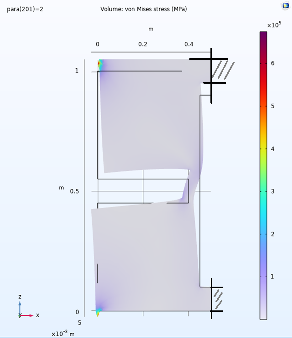

You do have symmetry. The symmetry is at the two boundaries you have selected.

I have selected the symmetry for two boundaries, but the results show that these boundaries seem not to be symmetric. This is my feeling, is it correct ?

Don't you have symmetry right at those boundaries, as indicated in my png?

I have symmetry in these boundaries.

And that is all that this symmetry condition gives; symmetry at those specific boundaries.

Thank you, now I understand.
