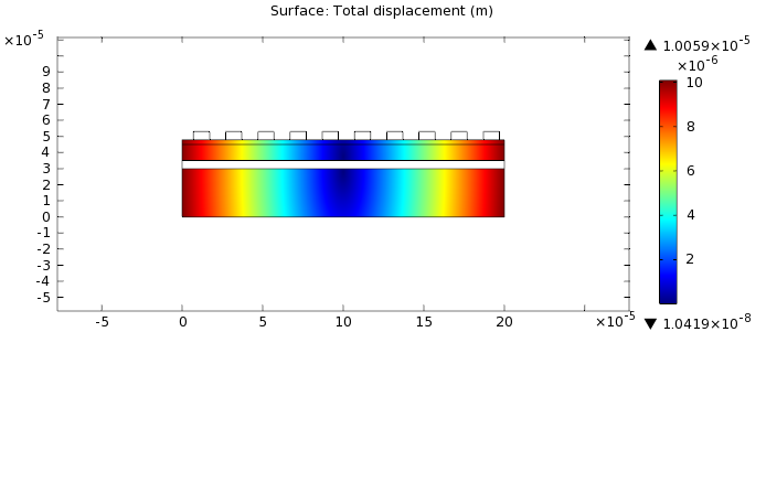

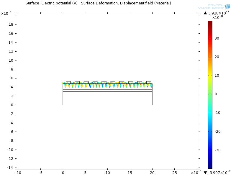

Thank you for your reply. I still have a few questions based on your comments about the model. But first ultimately what I wanted to do was first obtain the resonant frequencies of the SAW device, then study the changes and shifts in the device as I added a sensing layer to the center of the device and then when the sensing thin film material interacts with a gas. I wanted to be able to obtain results ultimately with my 3D model but I have scaled down to a 2D model to simplify the device and figure out where the issues I have had. I originally used an eigenfrequency study and obtained some various surface and potential plots at various frequencies I designated. Then for later models, I proceeded to add a frequency domain analysis.
From your comment, I thought that within the piezoelectric devices interfaces, that I had a mechanical constraint with setting a fixed constraint for my bottom layer (silicon) to prevent the device from tilting. I thought that was the main mechanical constraint I needed. In addition, I don’t understand how I still have disconnected regions from a structural mechanics points of view. How can I check this within the PZD physics interface and see this disconnect? In addition, I have been going back and forward trying to see if I need to be solving this as a plane strain problem vs. a plane stress figuring if this is having some effect on my model.
So I’m not sure if there’s also an effect of parameters that I used for the eignefrequency analysis is affecting the ability to do the frequency domain analysis and I did not fully remove these parameters or if there is something really wrong with the boundary conditions I have set since I continued to receive the failure to find an initial parameter and a singular matrix error even though I thought I had accounted for the BC for the model.
Any suggestions or comments would be helpful to the above would be greatly appreciated. Thank you. I’m also attaching some earlier eigenfrequency plots that I obtained at various frequencies too.

In total, you have 14 domains. Domain #4 is active in the Piezoelectric Material Model, domains #1 and 2 are active in the Linear Elastic Model 1, and the rest domains are active in the Electrical Material Model. It means that you are not solving structural mechanics equations in the domains 2, 5-14.
If you plot displacement field, you will see that only domains 1, 3, and 4 are colored, while the rest domains are white, as shown in the attached Figure. You need add all “white” domains into Linear Elastic Model node.
