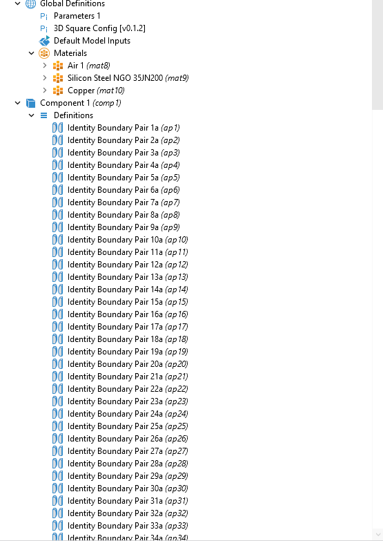

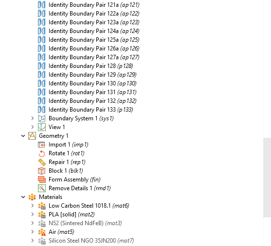

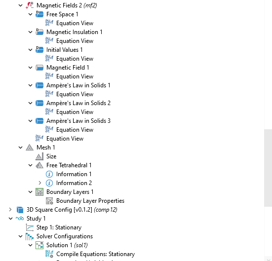

I attached a picture of my Model Builder Hierarchies, however, I'm not able to link my COMSOL model due to privacy concerns. Could anyone help me?
