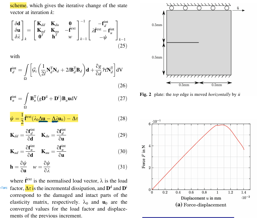

I am working on solving a nonlinear equation using the phase field approach with the arc-length method. I have implemented the phase field equation in the PDE coefficient form, but detecting displacement control with small steps is challenging in a time-dependent study. So, I think the only remaining option is to try coding the arc-length method.

The problem shown in your attachment appears to exhibit stable crack propagation, which should be possible to solve without the need for an arclength method. Please contact COMSOL support for further assistance.
