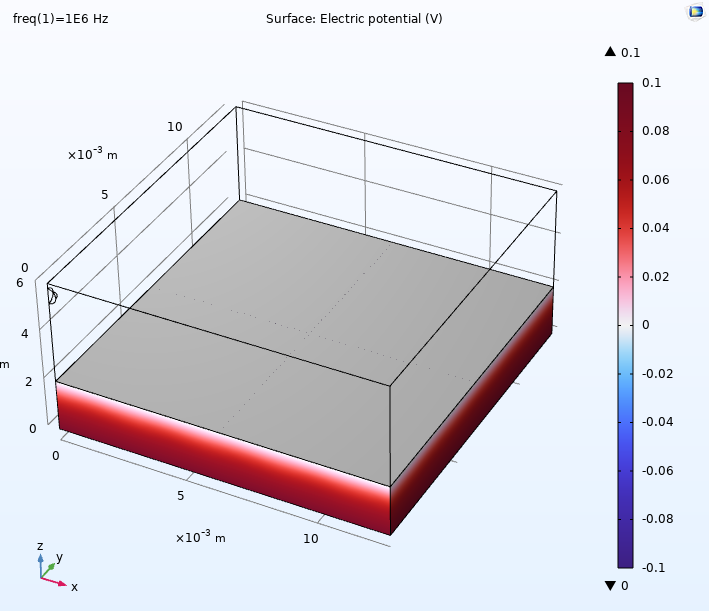

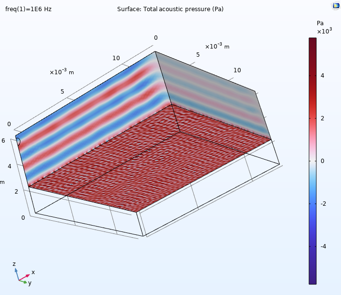

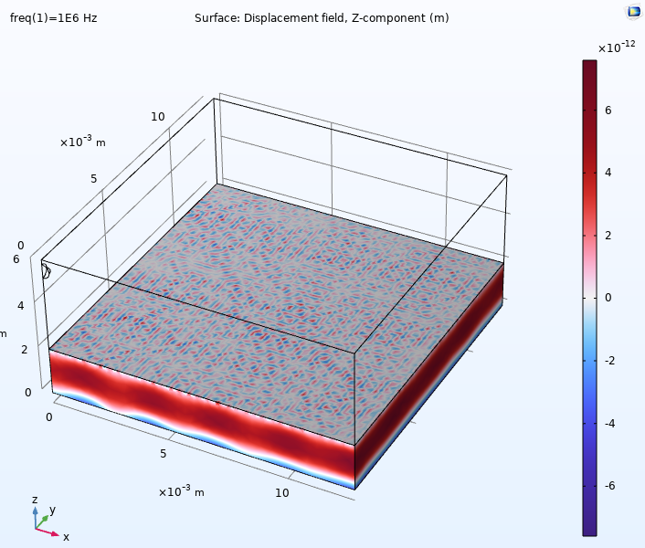

Hello, I am a student studying numerical analysis. I have a question that came up while using COMSOL.
I am currently performing an acoustic-piezoelectric coupled frequency analysis. In the image, the lower area is the piezoelectric region, and the upper area is the acoustic medium. For the boundary conditions of the piezoelectric element, I applied a surrounding roller boundary condition, with Electric Potential boundary conditions of 0V and 0.1V at the top and bottom, respectively. In the analysis results, the voltage was applied correctly, but the z-displacement and acoustic pressure at the coupled boundary showed uneven results. This issue did not occur when I used the same boundary conditions in COMSOL version 3.5. What could be the reason for this?

Are you using the same mesh in the newest version vs 3.5?

I think this is best resolved if you send the model to support. This could be one of several issues.
