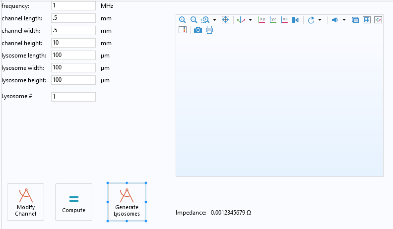

Posted 6 nov 2024, 18:29 GMT-5 LiveLink for MATLAB, Optimization 0 Replies
I am trying to create an app through app builder in which I can use assigned values within input fields to randomly generate cubes (lysosomes) inside of my defined rectangular channel with a specific material so that I can continue to run simulations. I want to click a button that is attached to a method to perform this action. I have MatLab code that creates the particles how I wanted to but I am unsure how to convert the code so that it would work in the method. I have all of my parameters linked to an input field within the app builder form as well. If using LiveLink would make more sense to do I would appreciate getting help on how to do that as well.

I also have attached pictures of what the form in my app look like. Any help on this would be greatly appreciated.
