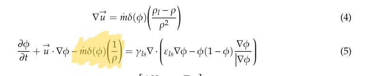

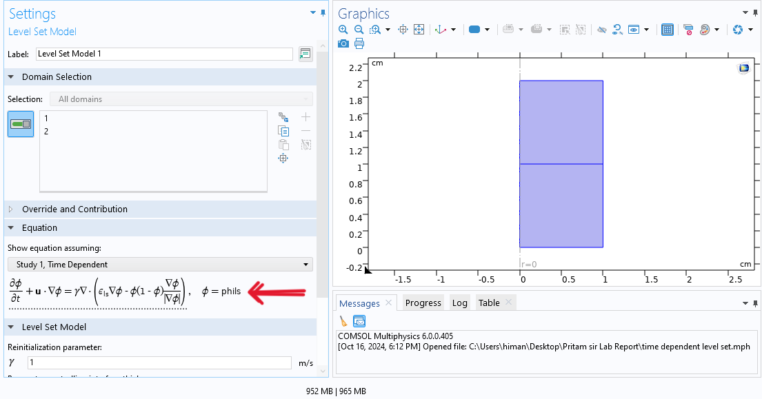

Hello I am trying to build a 2d model from level set equation .My equation is a modified level set equation with an extra term(highlighted the term). I have attached the image of the equation(equation 5). I want to add that term in the existing level set equation of comsol (attached the image of comsol interface). I cannot find the way to add new term to it. Please help me with that. Thank you

I have not worked with level set model of COMSOL but I have modified equations in other models where you can add the extra term by adding as a source term to your physics. If the level set module has an option to add source term or something similar, you can add the highlighted part of your equation there.
