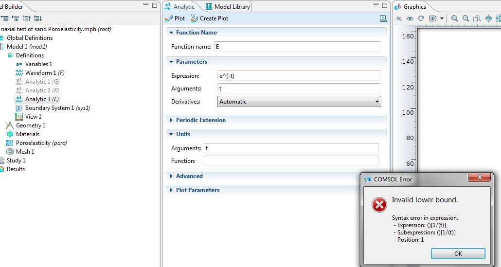

                                                    Thanks for your reply.
when I change it to -2*t, it still doesn't work, so what is the problem for the "invalid lower bound error" enclosed in the attachment.

for the plot further down on the definition node tabs you need to define the plot limits of "t", I expect then something is wrong there, check the doc
