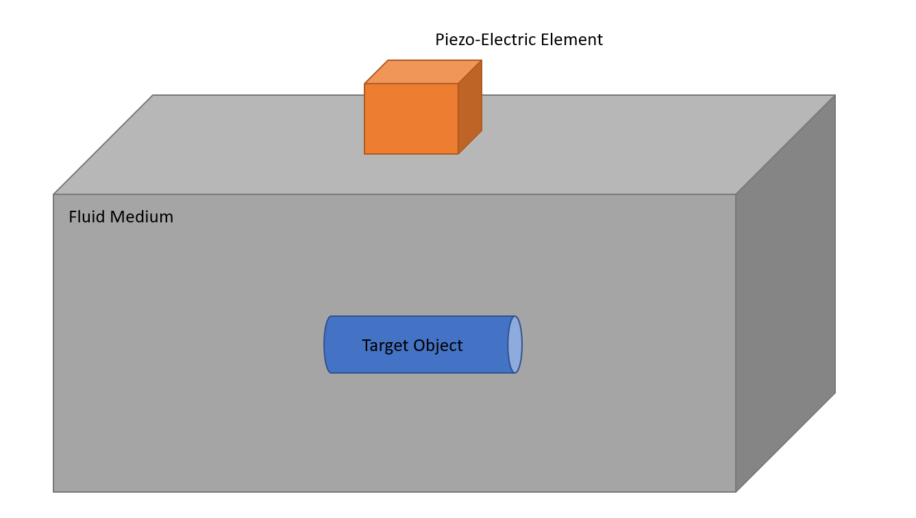

So my design consists of a Piezoelectric Element connected to a fluid element to diagnose test material inside the medium. When I designed this as a 2D design I obtained satisfactory results but when I upgrade to a 3D design with more identity pair and other parameters I got the error below The following feature has encountered a problem: - Feature: Compile Equations: Time Dependent (sol1/st1) Error in multiphysics compilation. Syntax error in low-level element syntax representation. - Name: elhwdg Duplicate domain number found - Detail: ind
I added the design picture as seen below

Did you every solve this error? I am experiencing the same one.
Thanks, Nick
