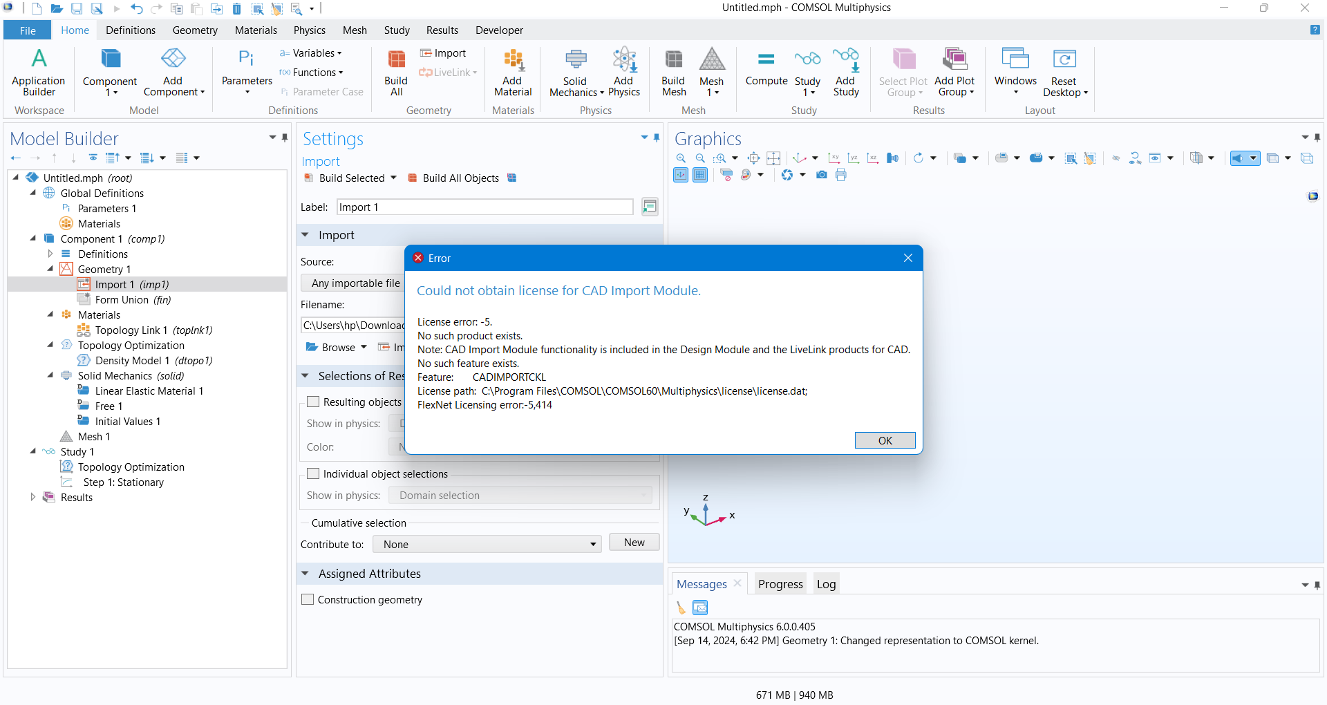

Excuse me for asking, but... do you have a license for either the CAD Import Module or the Design Module? If not, then I think that may be your problem.
Excuse me for asking, but... *do you have* a license for either the CAD Import Module or the Design Module? *If not*, then I think that may be your problem.

Manan,
The COMSOL software is licensed in the modular fashion. To see which products are included on the license you are using, go to File > Licensed and Used Products.

Hey, did you get the solution to your problem? I even checked the 'Licensed and Used Products' tab and I see 'CAD import module' is selected already. It was always working fine, don't know what happened now.
