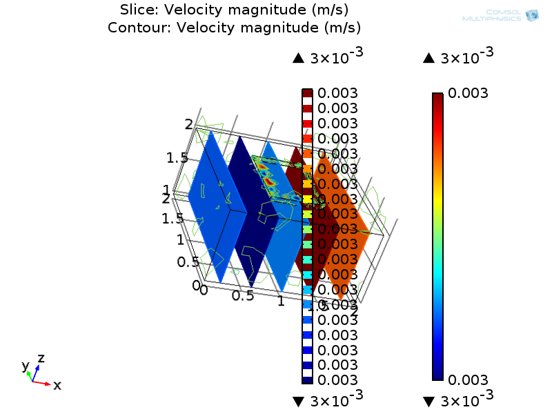

I am attempting to model a stream bottom seepage collection device, but I getting some strange results.
I am starting out fairly simple with no lateral flow in the free fluid, and setting the BC's so that I have a vertical flow field. But my results show the velocity contours have local maxima along the stream bottom under the device. I was expecting the maxima to be near the outlet of the device as it is a considerable constriction.

your image looks like a constant value with some numerical noise on it, no ?
The total mass flux should be something as the integration over a given boundary * fluid density*velocity vector normal to the surface, the latter is either one of the vector Cartesian components for an x,y,z normal plane, or a combination of the scalar product of the surface normal and the velocity vector component (nx*u+ny*v*nz*w)
At least that is what I would try first, but be sure you have a good value for the velocity (dense enough mesh values for a good gradient resolution
