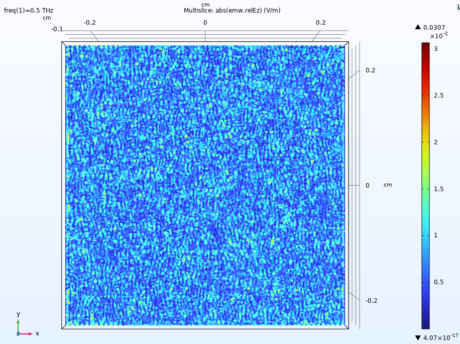

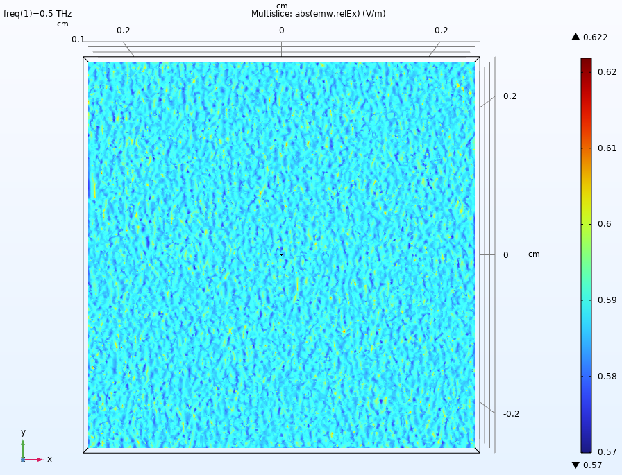

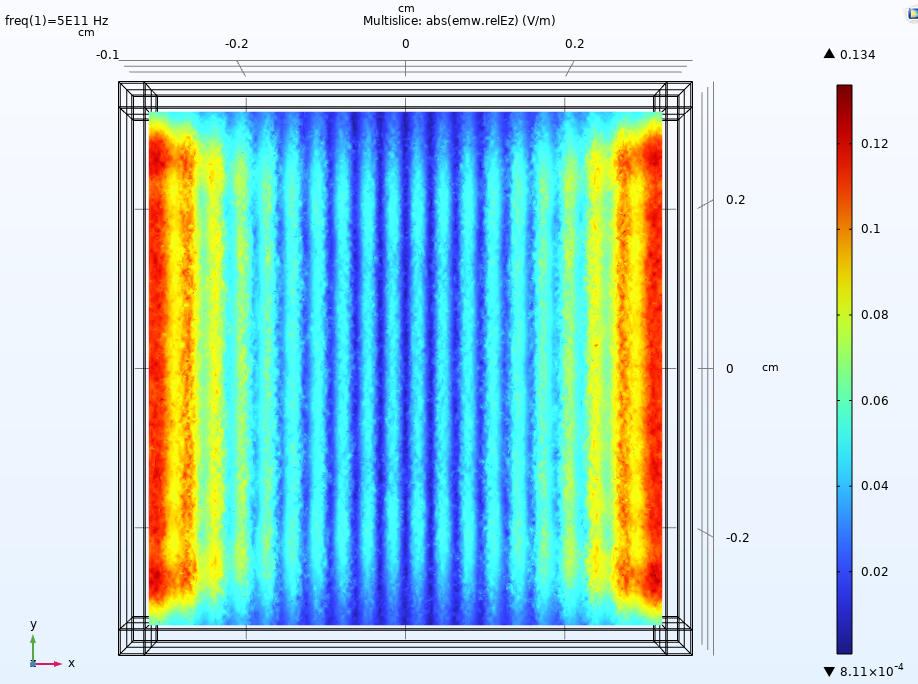

Hi, I am using the scattering field formulation for my model. I am using an x-polarized negative z-propagated plane wave as my background electric field. My structure is a box consisting of an air domain(top) and cancer domain(below). I used scattering boundary conditions. After the simulation, I realized that 1. emw.normE = abs(emw.Ex) 2. but abs(emw.Ez) is not = 0. if 1 is true, then how is 2 possible(since i am propagating the z direction anyways). or i am not plotting it correctly. I have attached my file. Thanks

Thank you very much for your help. I am however confused with some results. If I plot the background field in the xy-plane, I am supposed to get a fairly constant value. lets say I expect to get real(emw.Ebx) = -0.45 V/m. but I get real(emw.Ebx) = {-0.39 to -0.503}. I know theres is going to be computational errors and noise. Is there a way to the results as close to what I expect as possible?

The real part of any non-zero component of the background field will exhibit spatial oscillations with phase, just as it should. If you want to sanity-check the magnitude, plot abs of the field component of interest. E.g., plot abs(emw.Ebx), not real(emw.Ebx).

Thank you sir. Again, is it possible to get Electric field component in the z direction while the plane wave is propagating in the z direction?
Posted: 1 year ago 4 set 2024, 09:42 GMT-4
Are you asking a computational question or a physics question? A z-directed plane wave has no z component of E, but if it scatters/interacts with a material or boundary, a non-negligible z component might (or might not) arise, depending on the material and the details of the interaction. If a plane wave is normally incident (i.e., perpendicular to a flat surface) upon an isotropic material, then I would not expect any z component of E to arise, since there would be no change to the symmetry.
Are you asking a *computational* question or a *physics* question? A z-directed plane wave has no z component of E, but if it scatters/interacts with a material or boundary, a non-negligible z component might (or might not) arise, depending on the material and the details of the interaction. If a plane wave is normally incident (i.e., perpendicular to a flat surface) upon an isotropic material, then I would not expect any z component of E to arise, since there would be no change to the symmetry.
Posted: 1 year ago 4 set 2024, 11:23 GMT-4

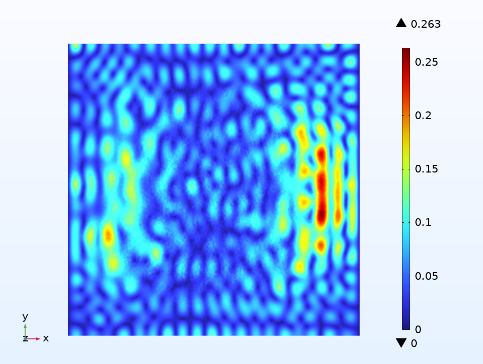

I was asking a physics question to relate it to computational. So for example, the model that you just helped me with, when i plot the abs(emw.relEz), i get 0.26 V/m amplitude while the abs(emw.relEx) gives 0.78 V/m. This makes the Ez component quite significant here. This is the reason for my question. can this be a simulation noise or something? If so, is there anything you recommend can help fix this?

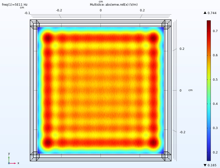

Posted: 1 year ago 4 set 2024, 11:58 GMT-4
Updated: 1 year ago 4 set 2024, 11:59 GMT-4
The scattering boundary conditions on the sidewalls are not really correct for this configuration. If you replace them with PECs on the walls normal to the x axis, and PMCs on the walls normal to the y axis, then those will cleanly fit the example incident plane wave and you will see the Ez component nearly vanish. If you are interested in exploring a non-normal angle of incidence, you may have to introduce some other boundary condition, such as perfectly matched layers, or even appropriately periodic conditions, such as Floquet boundaries.
Posted: 1 year ago 4 set 2024, 12:23 GMT-4
So you mean the boundaries on the X-axis should be PEC and the boundaries on the Y-axis should be PMC.? Is this because the plane wave is x polarized or the PEC and PMC on the boundaries does not matter.
Posted: 1 year ago 4 set 2024, 13:13 GMT-4
I have added two models , which one is the correct setup
Posted: 1 year ago 4 set 2024, 13:40 GMT-4
Electric field lines terminate on PECs, while magnetic field lines terminate on PMCs. As I explained, use the "PECs on the walls normal to the x axis." When discussing a vector quantity, "normal to" means "perpendicular to." This corresponds to your Example2.mph, for incident polarization (E) parallel to the x axis (and thus the PEC surfaces must be perpendicular to E).
Electric field lines terminate on PECs, while magnetic field lines terminate on PMCs. As I explained, use the "PECs on the walls normal to the x axis." When discussing a vector quantity, "normal to" means "perpendicular to." **This corresponds to your Example2.mph**, for incident polarization (E) parallel to the x axis (and thus the PEC surfaces must be perpendicular to E).

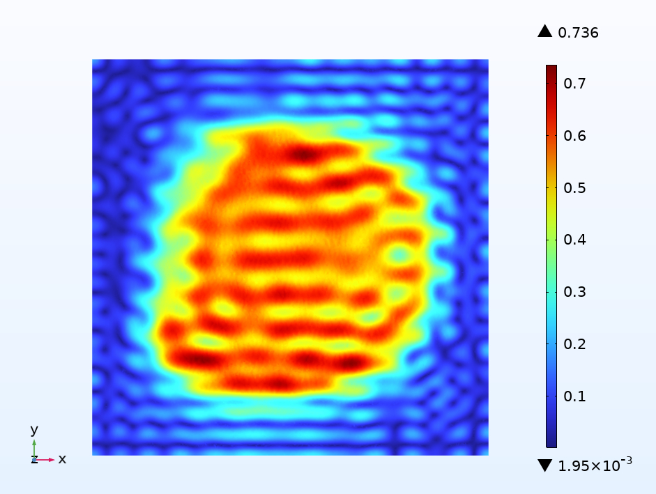

  • Hello sir, I used your suggestion on my problem above. I investigated both PEC/PMC boundary conditions as well as PML. I realized that PEC/PMC gave me the results I expected but the PML results is questionable. I wonder if I did something wrong using the PML. My geometry will become complex in the future so I dont want to rely on PEC/PMC . Is there anything I should do? I have attached my files and results . I welcome your suggestions.Thank you.

It seems to me that your objective here is to simulate a representative subsection of a larger space, perhaps even an array (in effect, if not necessarily deliberate). Of course, if your incident wave is at normal incidence, you can use the PEC & PMC sidewalls previously discussed. But if you want to consider cases where the incident wave is not at normal incidence, then you may wish to consider a model using Floquet boundary conditions. There are a number of examples in the Comsol Application library. See, among others, https://www.comsol.com/model/modeling-of-pyramidal-absorbers-for-an-anechoic-chamber-12129 . That application shows how to use periodic floquet boundaries, and also provides one example of the use of a PML, relevant to this kind of work. Perhaps the RF absorber in that model is analogous to the cancer tissue in your model? If so, studying that model might really help you. Good luck.

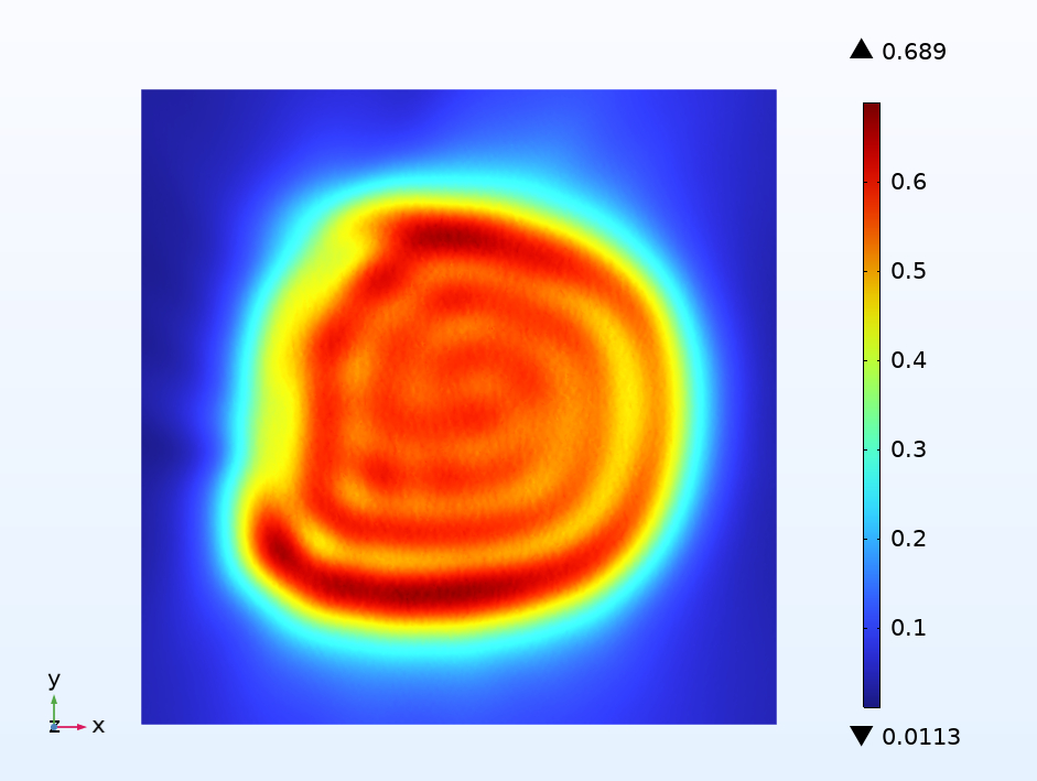

My wave is at normal incidence so the PMC/PEC walls was valid. However, my goal is to simulate a structure like seen in the attached file, called figure. Initially when I used SBC and PML, I was getting electric field components in the Z.which was what i did not understand since my plane wave z propagated. My initial guess was that, my structure might not be flat. This is why i decided to use a simple flat structure as I have shown in our previous exchange. I was getting Ez components which was solved when i used PEC/PMC walls. However, when I used PEC and PMC walls, on my real geometry (figure), the results gets worse. I even get Ey and same Ez component. The PML works better on my real structure than PEC/PMC. I am just trying to understand why I get Ez components regardless of what i use. And since my structure will get more complicated, I dont want to rely on PEC/PMC walls. Please refer to the attached files for confirmation. I couldnt get my .mph files to be less than 5MB, so if you need to review that, I can send it to you anyhow you prefer. Thanks.
