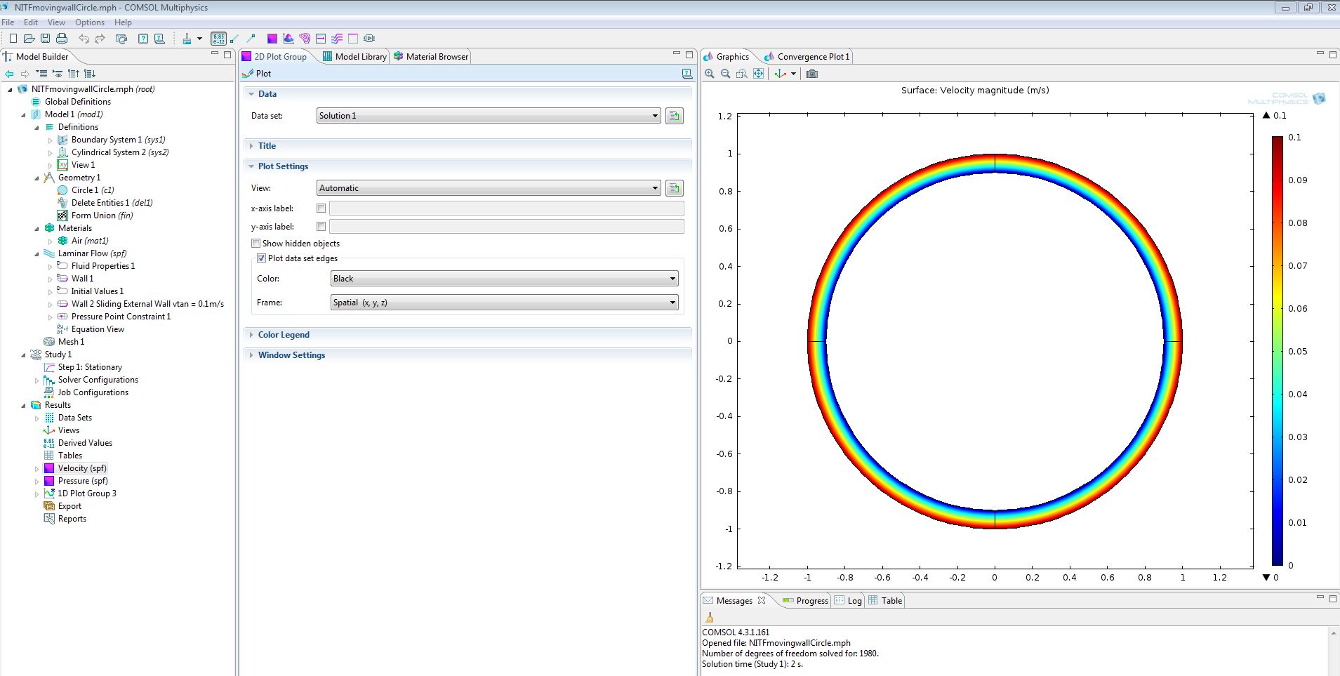

here is a screen view, very simple set-up (oops have a Opera <-> Java update issue cannot upload from here anymore, checking with IE)
Hi here is a screen view, very simple set-up (oops have a Opera Java update issue cannot upload from here anymore, checking with IE) -- Good luck Ivar
