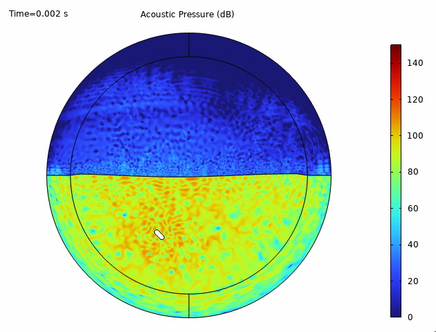

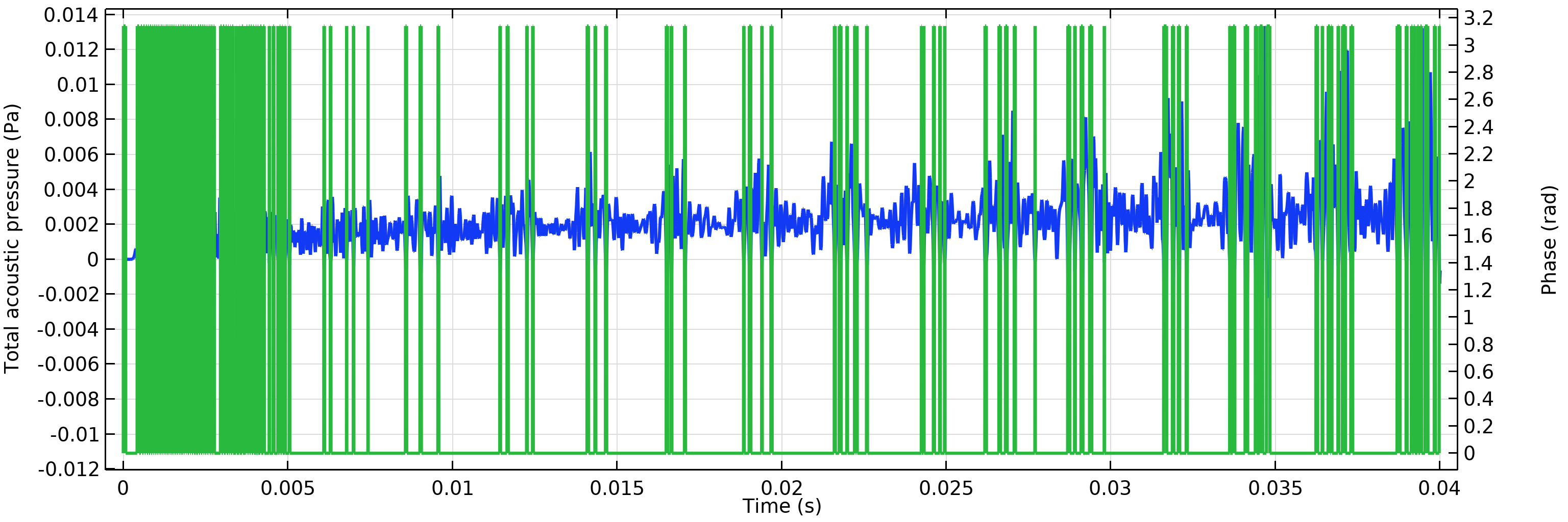

Hello, I am modeling an acoustic source in water and using the deformation geometry to model a water wave above it. My goal is to understand the phase of the acoustic wave at the water/air boundary. I am using the transient pressure acoustics where I can set the pressure amplitude. From this I can probe at the boundary section with the arg() operator to get phase, but the phase just switches between 0 and 3.14 radians (see attached image for response at a single probe point in the water). Is there a way to get a more granular phase output? Or what am I missing in terms of how COMSOL solves these pressure models?

The arg() operator is used for finding the phase angle of a complex number. If you are running a time dependent acoustic study, all quantities are real valued and therefore it is meaningless to use the arg() operator.
One thing to consider when modeling the problem is if the speed of sound in the water is much faster than the bulk water wave speed? This could allow you to decouple the problem - solve for a time harmonic pressure field at one instant when the wave profile is "frozen" in time.

As Mark said, arg is for complex numbers. For real numbers, there would only be two possible results; 0/2pi for positive numbers, and pi for negative numbers. So consider doing the analysis directly in the frequency domain, or converting the time domain results to the frequency domain if applicable.

Hi Mark, Thank you for your thoughts. I didnt realize the values were only real in a time domain study. That's helpful to know. I'll investigate if solving this problem with a stationary geometry in the frequency domain will work for my needs. Thanks again for the information.
