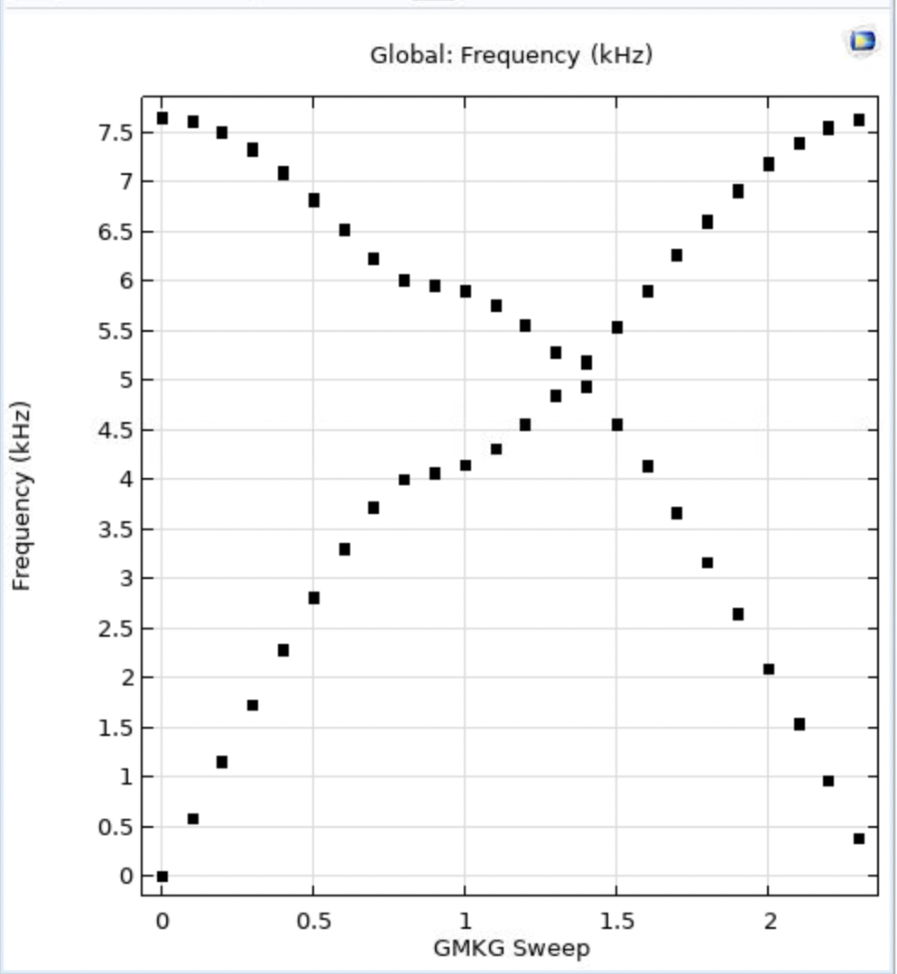

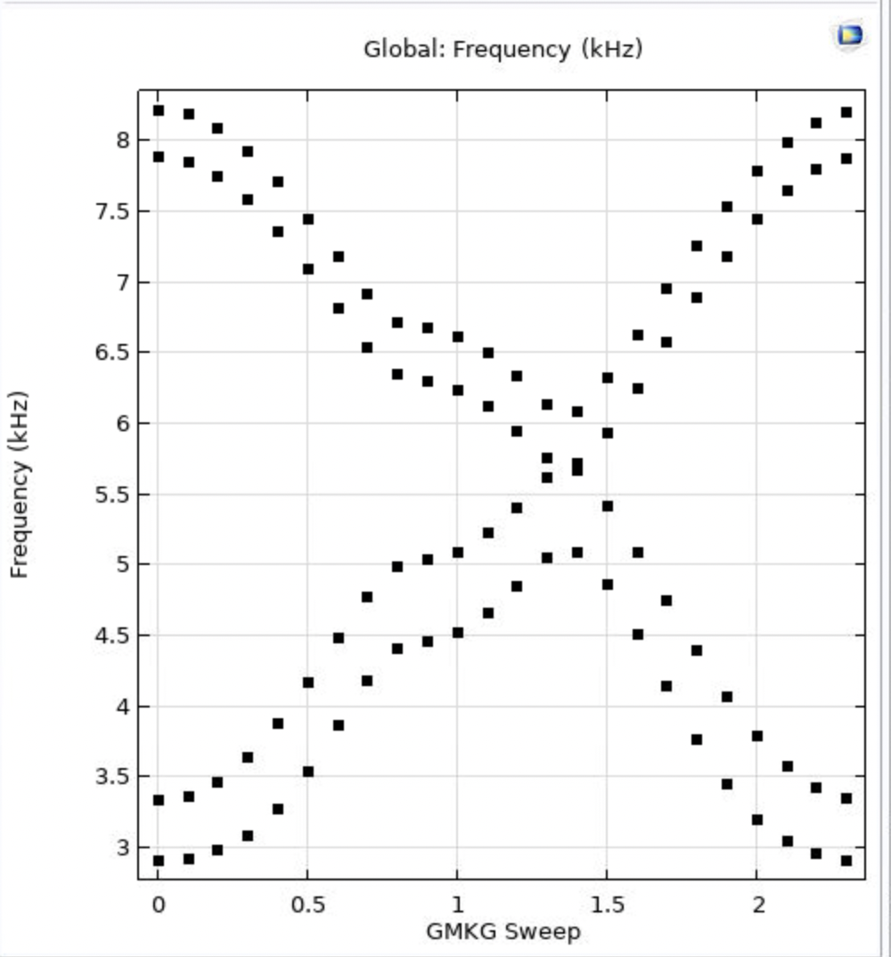

Hi René,
Thank you so much for the reply! I disabled the Solid Mechanics in the Eigenfrequency Study because I don't want to search for pressure modes/eigenvalues within the steel or wood. I'm only searching for the eigensolutions within the air cavities of my model. I've updated my file so that this can be illustrated more clearly.
My issue currently is that when I have the wood interlayer membrane (labeled domain 3) under Solid Mechanics, the coupling between the two layers doesn't seem to register. I've attached two screenshots, showing what I expect (and get when I select the interlayer domain under Pressure Acoustics instead) vs. what I get (interlayer under Solid Mechanics). I thought that the Acoustic-Structure boundary would properly couple the two domains, but it doesn't seem to be operating as expected. I'm wondering if there's something wrong with my modeling strategy that is resulting in this issue.
Also, would it change anything to select the interlayer domain under both Pressure Acoustics and Solid Mechanics?
Please let me know if my problem is still unclear.
Best, Jeffrey
Hi René, Thank you so much for the reply! I disabled the Solid Mechanics in the Eigenfrequency Study because I don't want to search for pressure modes/eigenvalues within the steel or wood. I'm only searching for the eigensolutions within the air cavities of my model. I've updated my file so that this can be illustrated more clearly. My issue currently is that when I have the wood interlayer membrane (labeled domain 3) under Solid Mechanics, the coupling between the two layers doesn't seem to register. I've attached two screenshots, showing what I expect (and get when I select the interlayer domain under Pressure Acoustics instead) vs. what I get (interlayer under Solid Mechanics). I thought that the Acoustic-Structure boundary would properly couple the two domains, but it doesn't seem to be operating as expected. I'm wondering if there's something wrong with my modeling strategy that is resulting in this issue. Also, would it change anything to select the interlayer domain under both Pressure Acoustics and Solid Mechanics? Please let me know if my problem is still unclear. Best, Jeffrey
