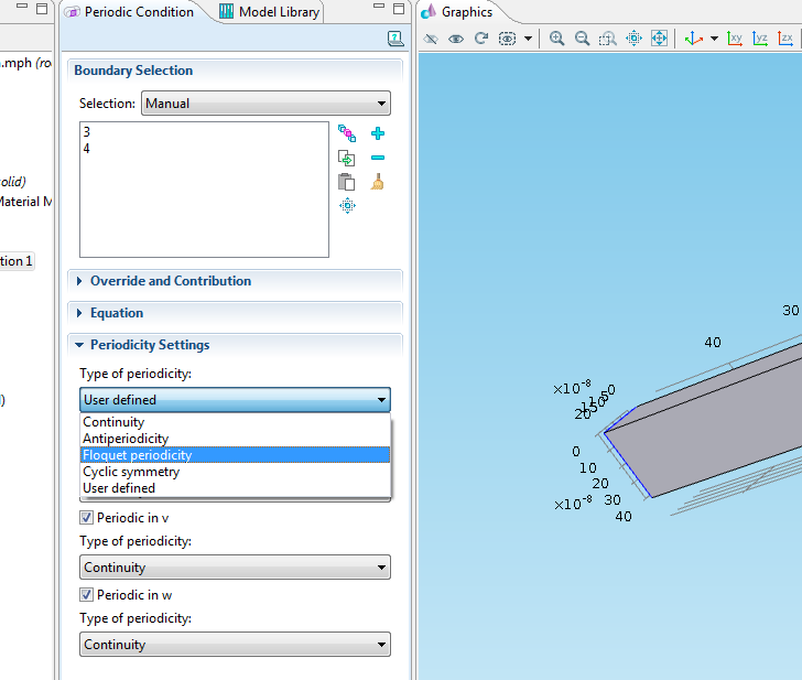

I'd like to ask a question concerning the modeling of elastic waves in the structural mechanics module. The geometry is a simple 3D beam, free on all sides. (file attached)
My goal is to study the elastic waves propagating in the z-direction - based on the full elasticity equations. However, currectly I see no good way to implement the requirement that the displacement field is a harmonic wave with wavevector K in the z-direction (explicit requirement attached).
When I simulate the beam with all-free boundary conditions, I do get some of those waves. But now it is not easy to extract the wavevector, and I get many modes that are not such elastic waves at all.
I have thought about using periodic boundary conditions, but I still didn't find a good way to just look for those modes with wavevector K.
Any help would be greatly appreciated!

thanks for your quick reply. Unfortunately, there is no such option in the 'periodicity type' menu. I can only choose between 'continuity' and 'antiperiodicity'.
Any other ideas?
Thanks again!
