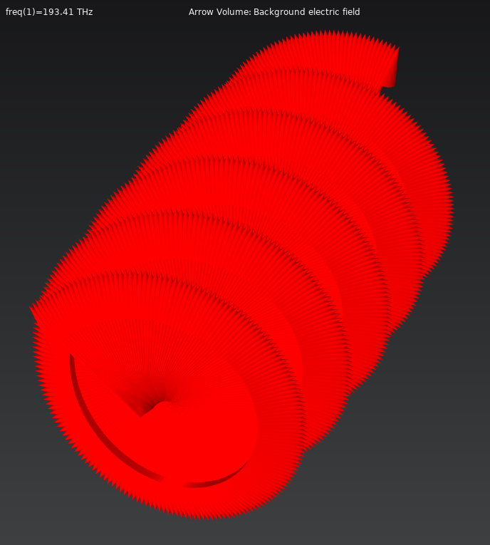

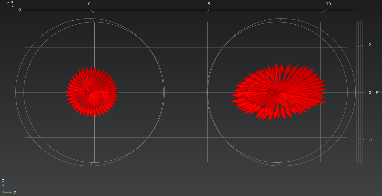

                                                    I don't have the wave optics module, but I ran your model using the RF module instead, replacing your terms with their equivalents.  And yes, I saw ~what you saw.  But then I realized that I was not looking at the incident (i.e., "background") fields, but rather the computed fields within the computational volume, which are impacted by the imperfect boundary conditions.  That impact includes reflection from boundary walls and ends.  This led to a partial standing wave in the cylinder.  In the RF wave module, plotting emw.Ebx, emw.Eby, and emw.Ebz yields the background fields, while plotting emw.Ex, emw.Ey, and emw.Ez yield the field in the presence of the actual boundary conditions.  May I assume you have a similar option available for looking at the background field components, in the wave optics module?  If so, I sugggest you try that.

                                                    Indeed this is an option in the wave optics, and indeed it does show that the background field is circular. Obviously, this is a simplified model but seeing the effect everywhere else I looked and not noticing the background option I had run out of solutions. Thank you.
