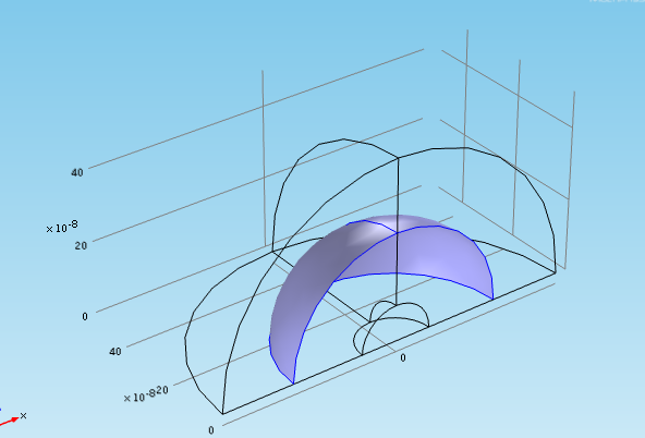

First of all, thank you so much. I can now see a resonance peak at the right spot. However I have some final questions:
Scattering cross section:
- in the integral you wrote Re(Escat - H*scat): Do you mean norm(Re(Erelx-H*relx, Erely-H*rely, Erelz-H*relz)) ?
Absorption cross section:
- you wrote a sigma(omega) term. What is that and if it is the electric conductivity of air, where do you find the dependence of frequency? Is it not just 0?
Once again thank you for you patience and help.

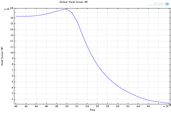

I have received some emails asking me if I was already able to plot the absorption and scattering cross sections of a gold sphere, so I know that this is a topic of general interest. As I said in the last post I was already able to obtain a resonance peak of the scattering cross section. Nevertheless the values don't correspond to the Mie values obtained for the COMSOL 3.5 version. I send an attachment with my results and the expressions I used.
I only defined in Parameters: E_inc as 1[V/m] and introduced the expressions for the cross sections in Definitions - Variables.
You can see the expected and obtained results, together with the expressions I used. Can you please comment on these for the general community? We would all appreciate.

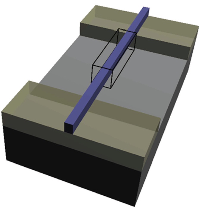

Dear Davletshin
i tried to get the density fluctuation from the time dependent or frequency dependent studies but i get a fixed value for the density, i think i should get the fluctuation and then multiply by the refractive index (3.5) and then i put it as a diagonal refractive index in the wave equation of the RF, please if you have any idea ?
Best Regards
Dear Davletshin
i attached to you the wave guide pic just to see it and may it helps you to think in way with me to solve the problem.
best regards
