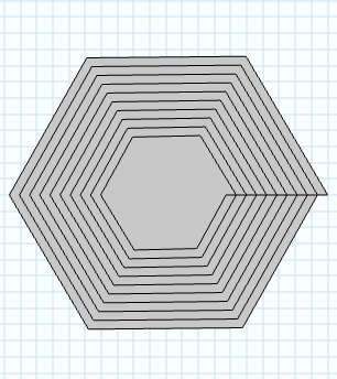

I have included the equation in the simulation and find the hexagonal shape in attached file. But, it looks kind of mismatched with ends.

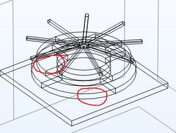

But in my simulation, where I want to change the coil shape is Helix type, I chosen helix coil from Geometry.
Suggest, where to put those equations.

Posted: 2 years ago 4 mag 2024, 12:59 GMT-5
As I wrote in my first post you must change the object type from solid to open curve.

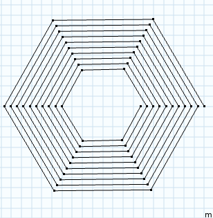

Yes, I changed to open curve and it works what you have said (see the attachment) The design I showed for hexagonal coil was 2D. But for my design I want to do it in 3D. I saw people use parametric curve in designing circular type helix coil. The equation you have posted works for sure.
It will be more helpfull, if you can guide me to draw it in 3D. Which ptimitive should I use here. Where I can put this equation ?
Now question is should I use multi-turn coil or set of single turn loops? Assume that its a hexagonal shape inductor.
>As I wrote in my first post you must change the object type from solid to open curve. Yes, I changed to open curve and it works what you have said (see the attachment) The design I showed for hexagonal coil was 2D. But for my design I want to do it in 3D. I saw people use parametric curve in designing circular type helix coil. The equation you have posted works for sure. It will be more helpfull, if you can guide me to draw it in 3D. Which ptimitive should I use here. Where I can put this equation ? Now question is should I use multi-turn coil or set of single turn loops? Assume that its a hexagonal shape inductor.
Posted: 2 years ago 5 mag 2024, 02:30 GMT-5
You can draw this thing on a workplane in 3D. I think it is a single turn coil because it is not a closed curve.
