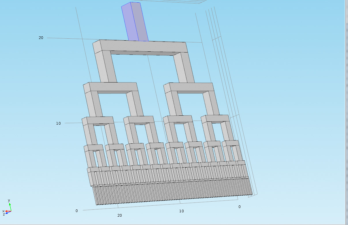

I took your advice and rebuilt the network with the mirror symmetry (see attached). I added a boundary layer as Ivar suggested. Thanks for sending me the example swept mesh. Is the partitioning necessary because the model does not have a constant depth, and beginning and end faces of the mesh sweep must match? When meshing the new model I opted to stick with the free tetrahedral mesh because partitioning and sweeping was too tedious. The tedium was due to an...

I just ran the new model (halved and mirrored) with glycerol as the material using the boundary layer meshing (4 layers instead of the default 8 -- I wanted to save time, but I will increase that number if I need to). I am currently solving the same model with the power-law fluid. The flow through all of the outputs is very even (see the pictures-- glycerol at 92 psi). Fortunately, this agrees very well with experiment. I can show you videos if you don't believe me ;)

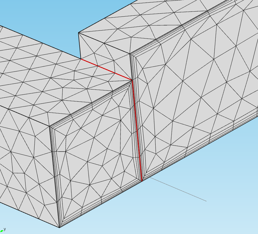

One thing I noticed that may or may not help. I saw that you have generated boundary layers on some artificial unphysical boundaries (see attached png). With these boundaries removed from the boundar layer operation, you will need to check "trimming" instead of "splitting" to avoid errors. Trimming unfortunately doesn't give you as much refinement at the corners. Overall, with this technique you will save about 6% in total element number. See attached mph. The reason I say this may not help is that you are losing some of the refinement at the corners with this technique. The benefit is that you are removing a lot of unnecessary refinement on the unphysical boundaries.
I suppose In the end, if you are getting convergence and good accuracy in a reasonable amount of time then no need to fiddle with perfecting the mesh.

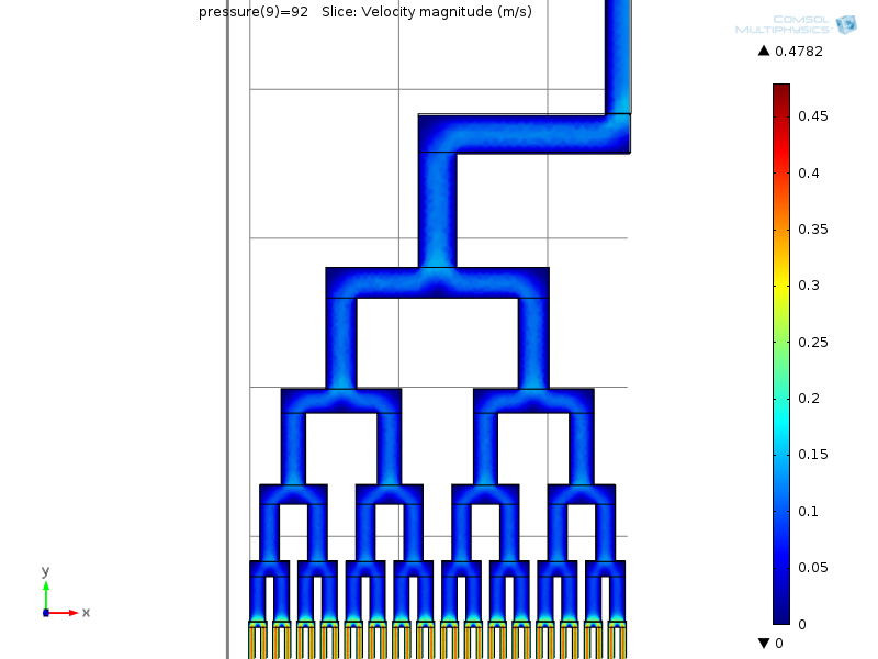

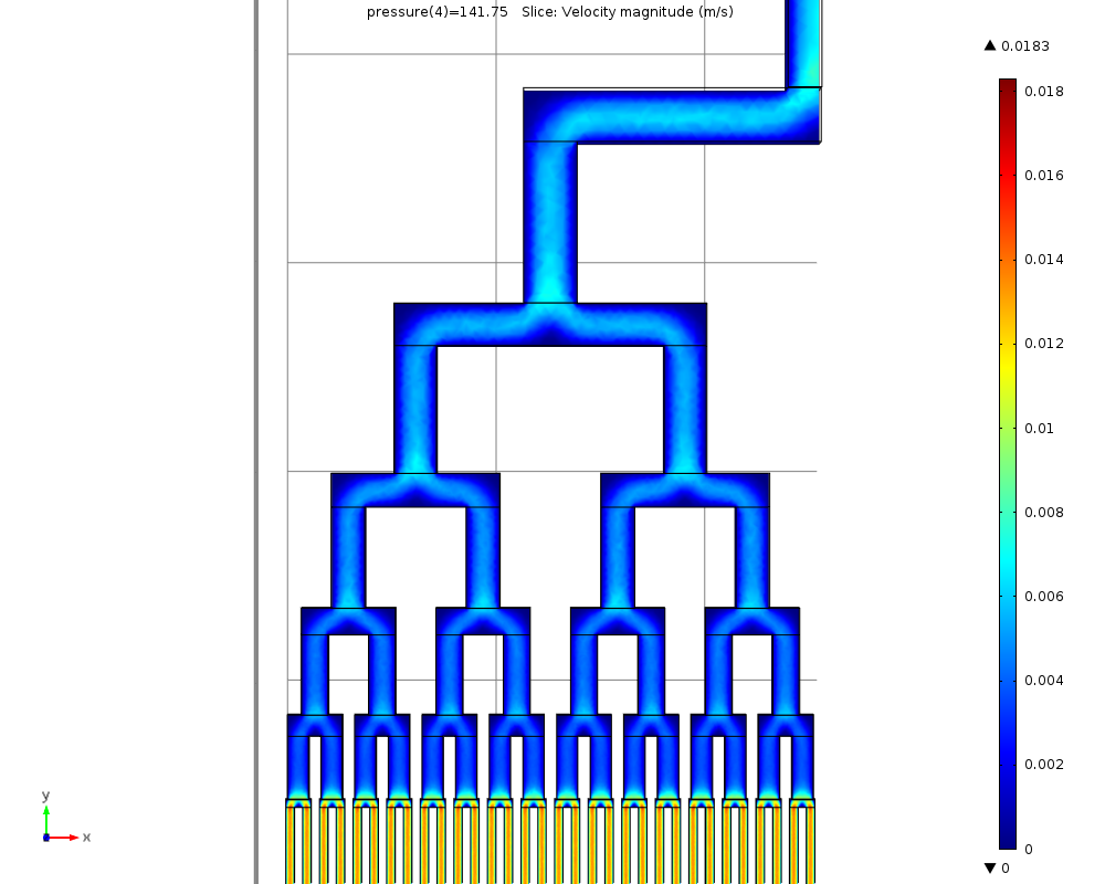

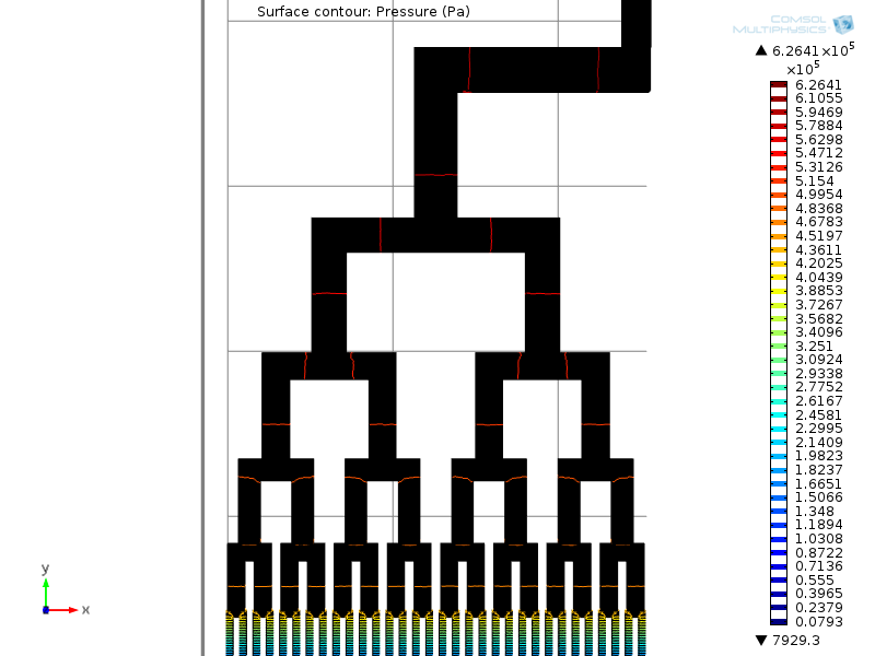

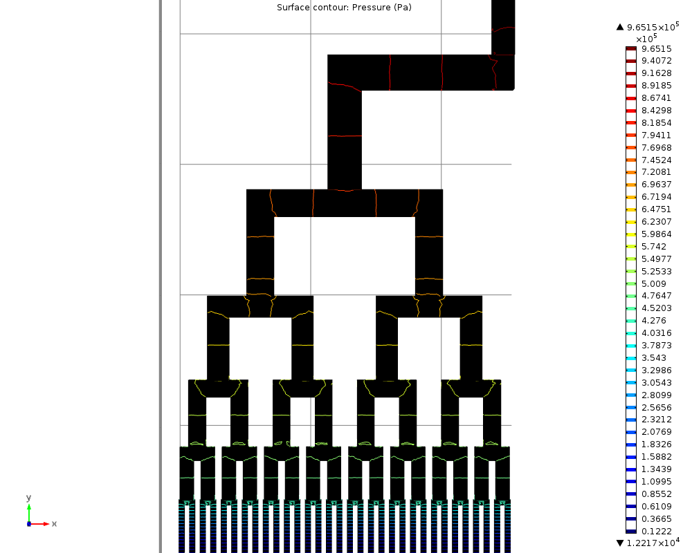

I ran a parameter sweep of the power-law fluid (wax) at pressures of 70, 105, 140, 175, 210, 280, 350 and 420 psi. The solutions converged for the first three pressures (70, 105, 140), But did not converge at 175. What surprised was that comsol then solved for pressures of 157.5, 148.75, 144.375, 142.19, and 141.75. At 141.75 (attached) it converged. I guess COMSOL was trying to find the max pressure it could converge at - pretty clever.
I think that at higher pressures, the shear rate difference is large and creates a large velocity gradient that is not resolvable with my current mesh. I will try re-solving the simulations with the boundary layer number set to the default of 8 (as opposed to 4). Regardless of whether this works or not, I will next try Nagi's suggestion of the Carreau model fluid with the boundary layer of 4.

I see what you're saying about meshing the unphysical boundary-it's a good point. However, as I mentioned earlier, it is not easy for me to select large numbers of boundaries because of this apparent bug in v. 4.3 (perhaps I should make a separate thread for it). I agree that fixing the boundaries would result in a more efficient mesh, but currently I'm not too concerned with the time to solve (I set it to solve and come back in several hours).

I ran a parameter sweep of the power-law fluid (wax) at pressures of 70, 105, 140, 175, 210, 280, 350 and 420 psi. The solutions converged for the first three pressures (70, 105, 140), But did not converge at 175. What surprised was that comsol then solved for pressures of 157.5, 148.75, 144.375, 142.19, and 141.75. At 141.75 (attached) it converged. I guess COMSOL was trying to find the max pressure it could converge at - pretty clever. I think that at higher pressures, the shear rate difference is large and creates a large velocity gradient that is not resolvable with my current mesh. I will try re-solving the simulations with the boundary layer number set to the default of 8 (as opposed to 4). Regardless of whether this works or not, I will next try Nagi's suggestion of the Carreau model fluid with the boundary layer of 4. [b]Josh,[/b] I see what you're saying about meshing the unphysical boundary-it's a good point. However, as I mentioned earlier, it is not easy for me to select large numbers of boundaries because of this apparent bug in v. 4.3 (perhaps I should make a separate thread for it). I agree that fixing the boundaries would result in a more efficient mesh, but currently I'm not too concerned with the time to solve (I set it to solve and come back in several hours). [b]Ivar,[/b] This bifurcating network design yields surprisingly even outputs. Partly because the Reynolds number is so low (~10^-4 to 10^-6), it is closer to creeping flow than laminar. I could probably solve it as creeping flow (neglecting the Stoke's term), but in a few experiments it didn't seem to save much time, and I don't see the harm in solving for laminar flow. What [i]can[/i] result in uneven flow is if the vertical section of each generation of bifurcations are very short compared to their widths. In my example, the aspect ratio is 3, but even at 1.5 it still works well. Also, I found (I think) that a network with more generations is less susceptible to unevenness of flow due to inertial effects of a short vertical section immediately after a bend.
