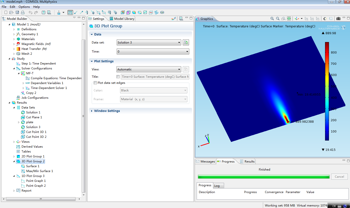

I have modeled it similar to your guide ,but i found the heating result isnot equal to the cooling one(t=0s),what's the reason?
i pasted my temperature graph as follow, in the picture solution 3 is temperature field of heating,solution1 express
the cooling initial, why they are difference??
could you give me some advice

From looking at your screenshots, it's not clear to me exactly what your study set-up is. What do you mean by heating result and cooling result?
Would you be able to post your mph and give more explanation?

after modeling the induction heating,I would like to use the known temperature distribution to simulate a natural cooling or water cooling process. the cooling initial and the known temperature field should be same theoretically
my model is too big to paste,so could you give me your mail?
thanks a lot

my model is to big,so i paste a simplified 2D model with a similar Physical process,my actual model is a moving 3D one,the inductor move upon the plate
appreciate to your reply

I see what you are talking about and the reason is because when you divide your analysis into mutliple steps/studies the initial conditions for the cooling process must be "calculated" based on the input. For this reason, there is a slight difference due to the solver initializing the input conditions. This initialization step is important for some analyses where the initial field contiions need to be made consistent with the boundary conditions. In this case, it just makes a slight change to the values.
To avoid this, consider performing your analysis in one step. You can turn off the magnetic heat source by defining a step function that is smoothed and drops from 1 to 0. Right-click on Defintions and select Functions>Step. Then multiply your heating term by an appropriate step function so that it drops off after 10 seconds. Then run your simulation for 11 seconds. This will be a more realistic simulation of what's going on anyway.
