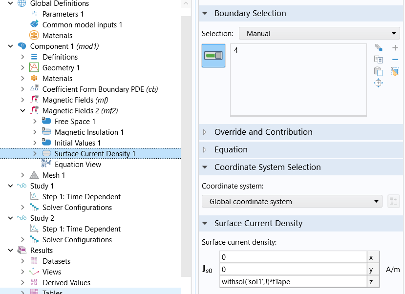

Thanks for the reply!
I had already seen these functions (setind and setval) but from what I understood, as you also reported, they allow you to define the withsol function only at certain moments of time or for certain values.
For example withsol('sol1',expr,setind(p,2)) refers to the second time instant, right?
What I would like to do is something like ('sol1',expr,setind(p,All_timestep)) where the values of p at each time step are taken into consideration.
Is it possible to do this and how should I write the withsol function?
