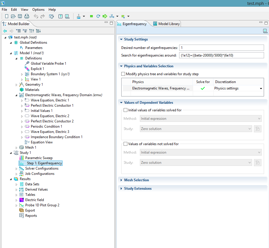

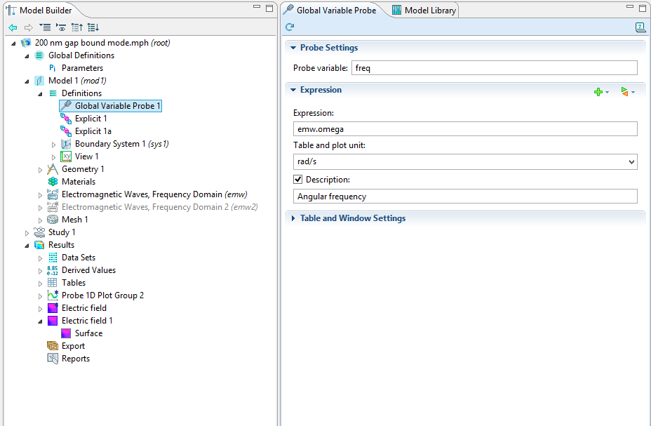

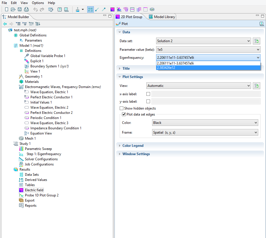

Thanks Ivar,
I understand the meaning of a complex eigenfrequency, my problem is simply that I ask for 1 eigenfrequency, yet comsol insists on giving me 2 eigenfrequencies, which is a problem for me. I don't know why comsol is doing this, but there is another solution to the problem. Let me phrase it this way:
Right now I have a probe that is set to probe the expression "emw.omega" (see attached screenshot), however, comsol solves for multiple eigenfrequencies, so it is finding several emw.omega values. If I probe emw.omega, it only probes the most recent emw.omega (ex. if I solve for 6 eigenfreq, it will output the 6th eigenfreq). In previous versions of comsol, if you wanted to probe say the 3rd eigenfrequency, you would simply probe "emw.omega(3)". Comsol 4.3a rejects this, so my question is, do you know how to tell the probe which solution to observe?
Thanks,
Chris
Thanks Ivar,
Thanks,
Chris
Ivar KJELBERG
Posted:
1 decade ago
20 dic 2012, 21:13 CET
have you tries with the with(3,...) operator ? (you also have the at() for time series) there are many new operators in v4.3a, check the help on "operators". This might give you the solution. I do not know why you getr several modes, the best is to ask support for such things ;)
