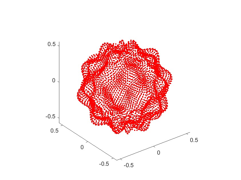

I have a following problem. I have a cloud of points in a format x y z in each row of the text file.
This cloud of points represents a 3D boundary of some soild. I have to read the points, treat them as a boundary of a solid, probably convert to a solid. Then, I have to compute some BVP using: Coefficient Form PDE. My cloud of points represents a 3D boudary.

Thank you very much for your quick answer. The post seems to help in a little bit different case, i.e. when we have a cloud of points that form an open surface. In my case a cloud of points looks like a kind of irregular sphere (see the picture enclosed). I tried to change some options in Comsol, but the result seems to be like a surface, not like a 3D boundary. However, you know Comsol much better.
With best regards, Malgorzata

Why not split the data into several patches that add up to the full surface?

Dear Jeff. I am afraid this boundary is rather irregular. The points are generated with some algorithm proposed by my colleague. I am not convinced how to split the data into several patches and if it is even possible. With best regards, Malgorzata
