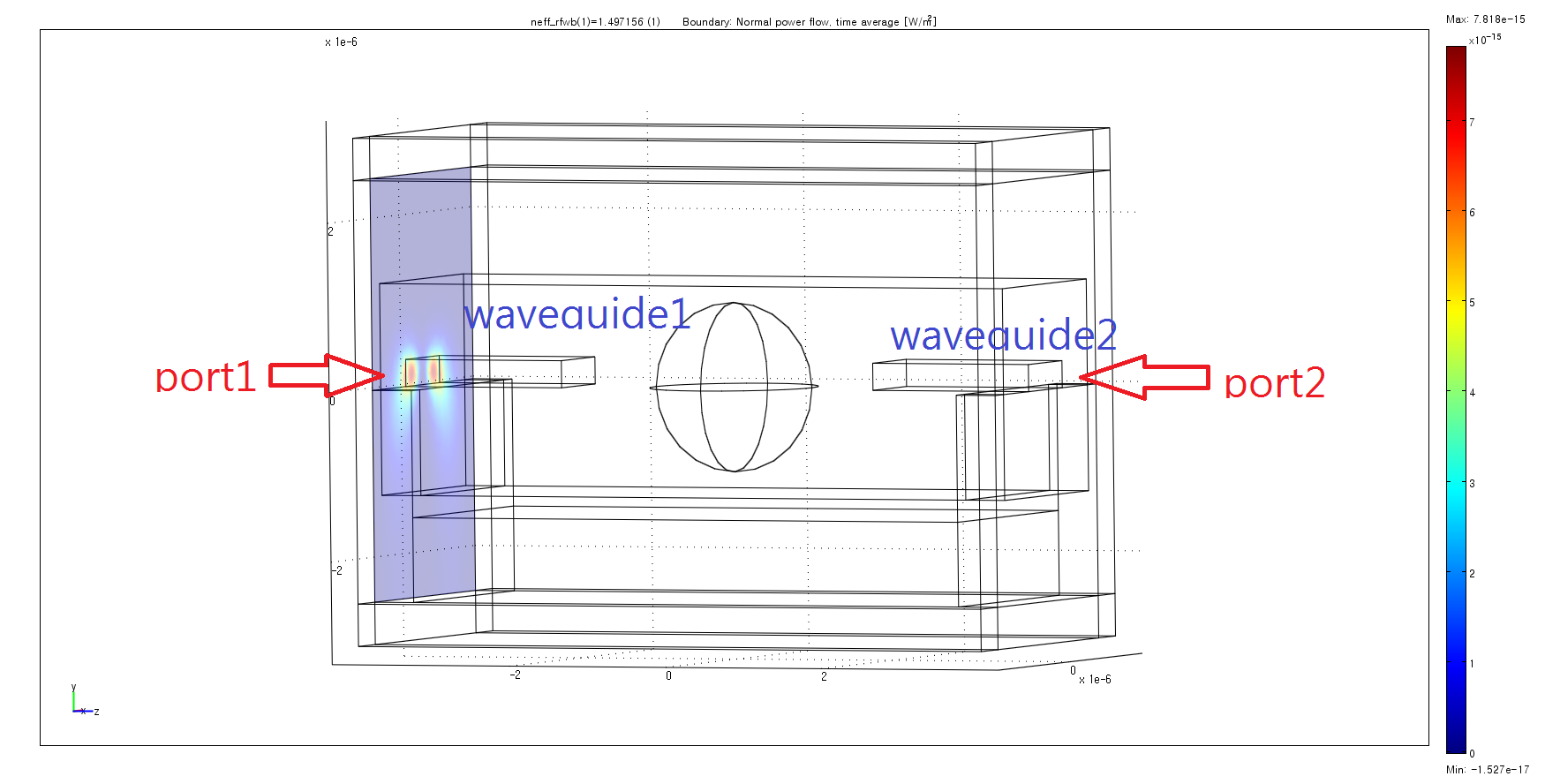

To propagate the monochromatic light of 1550nm (1.935e14 Hz ), I've put two extremity of the length of Silicon waveguide1 and waveguide2 as "excitation port1 and port2"(type "numeric", input power:1watt)
For the result of the "Boundary Mode Analysis", I can obtain the solutions of "effective mode index".
One problem is here. When I simulated by "Boundary Mode Analysis" , I couldn't get results from waveguide 1 and waveguide 2 simultaneously. So I restored just one boundary result from waveguide1 surface.
So as for the distribution of intensity of electric field, it's just result from waveguide1.

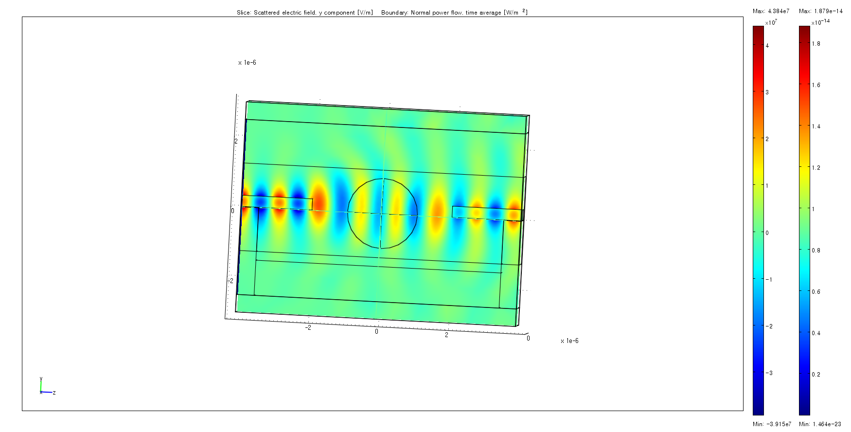

So my question is How can I get results from waveguide 1 and waveguide 2 simultaneously and
why I can't obtain a good distribution of electric field, because results seems abnormal theoretically (at least I think It will be symmetric.). Maybe there are some nessesary parameters that I haven't defined?

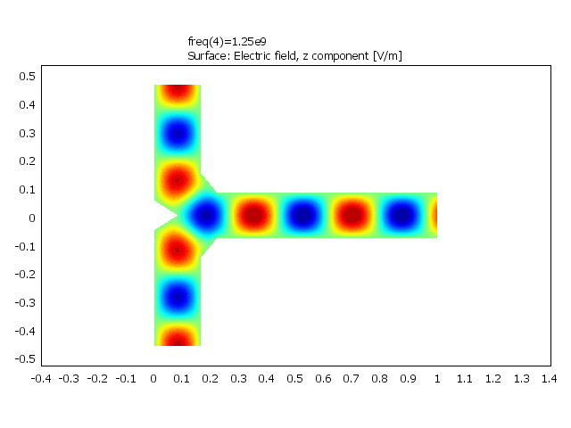

Actually, you CAN have multiple active input ports. I do it all the time and it is useful for computing how fields combine in microwave systems with more than one input. However, when you turn on more than one port at once, the S-matrix components will not be made available to you explicitly in the post-computation list of available quantities. Nevertheless, you can still construct the input and output powers, and you can certainly observe the phases as well, by means of defining integrals at each port of interest and/or plotting fields at points on the ports.
An example of a rather trivial case (combining 2 waveguide inputs in 2D) is presented in an animated .gif file (prepared with the old Comsol 3.5a) attached to this message. Just open and view it in your web browser to see the animation.
Actually, you CAN have multiple active input ports. I do it all the time and it is useful for computing how fields combine in microwave systems with more than one input. However, when you turn on more than one port at once, the S-matrix components will not be made available to you explicitly in the post-computation list of available quantities. Nevertheless, you can still construct the input and output powers, and you can certainly observe the phases as well, by means of defining integrals at each port of interest and/or plotting fields at points on the ports. An example of a rather trivial case (combining 2 waveguide inputs in 2D) is presented in an animated .gif file (prepared with the old Comsol 3.5a) attached to this message. Just open and view it in your web browser to see the animation.

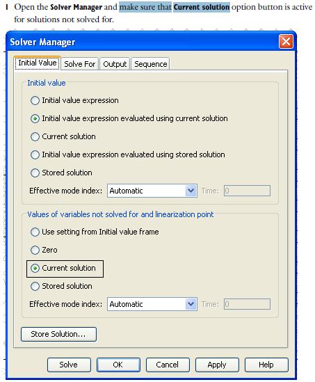

Posted: 1 decade ago 7 ott 2013, 12:23 CEST
I think I solved my and your problem : go to page 59-62 of the User's guide of the RF module.
I attached an image, because the manual isn't perfectly clear.
I think I solved my and your problem : go to page 59-62 of the User's guide of the RF module. I attached an image, because the manual isn't perfectly clear.
