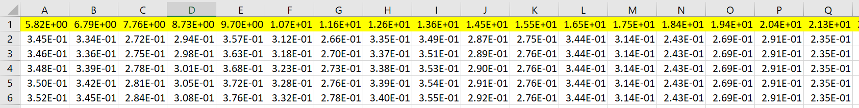

I have done some test but I didn't understand how I have to define my data. As I have read it's not possible used a grid with more 3 rows, is it correct? I have a file excel defined as in photo in which the yellow cells are the x coordinates and the rows from 2 to 6 are the number of timestep i.e. 1s, 2s, 3s...
How can I define a f(x,t) function in Comsol with my data?

Hi Marianna,
in the lines below the %Grid line you specify the nodes of your function, i.e the x and y values, or x and t in your case. So the first line would contain all the x values in the yellow line. The second line contains the t values, e.g. 1, 2, 3, etc. You don't need a third line because you only have two arguments in the function.
Below the %Data line you specify all the data values f(x, t) for the nodes in your function. Those are all the values in the white lines in your Excel sheet. They do not need to be structured in lines. This will be done according to the data under %Grid.

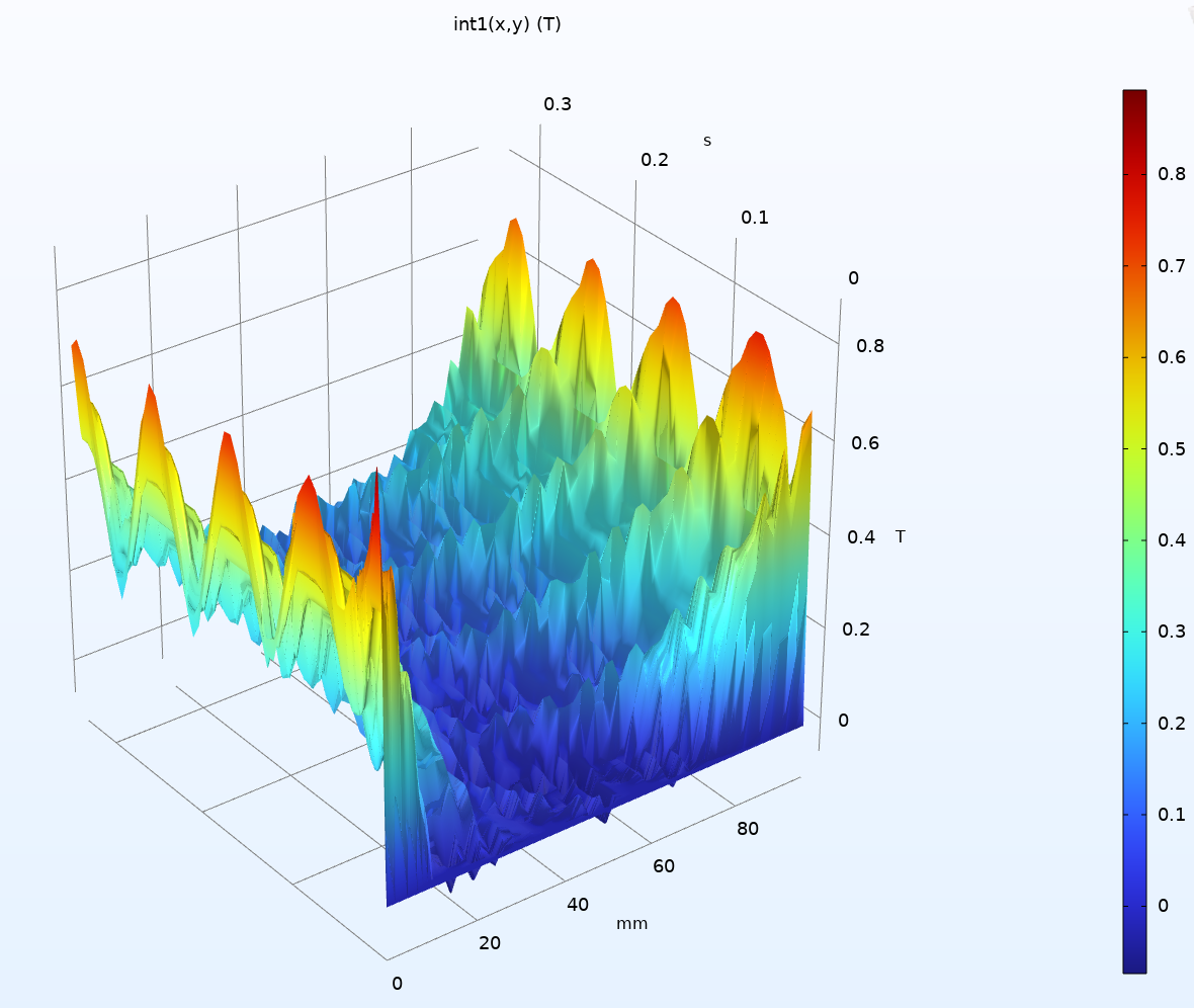

Hi everyone, first of all thank you for helping me!
I finally fixed this problem and got the graph shown in the photos which is exactly what I expected.
Now I have another problem related to simulation convergence. I imposed the function int1(x,t) in the magnetic field-point constraint section as mf. By-(int1(x,t)) and I've tried changing some solver settings but it doesn't work.
Do you have any suggestions?

Hi Marianna,
First: I think you have an issue with units and the location of the int1 function. The function is set up with mm and Comsol expects m in the constraint.
Second: The x-axis is ranging 0 ... 100 mm, while your line in the geometry is located -50 ... +50 mm. I changed the constraint expression to: mf.By-(int1(0.001*x+0.05,t)) It may be better to set up the input data in a way that fits the geometry.
Third: In the time dependent solver it is advisable to choose manual time stepping to make sure the solver properly samples the function in the temporal axis. I changed the time stepping to 'Generalized Alpha' with manual stepping and a time step of 1/(f*100). You can check if a larger time step still gives good results.
Fourth: I think the mesh on the constrained lines is not fine enough to properly sample the spatial dimension of the constraint. I changed it to equidistant distribution with 1000 elements. Maybe less works as well.
The model solves with those changes, and you will see if the results match your expectations.
Cheers Edgar
