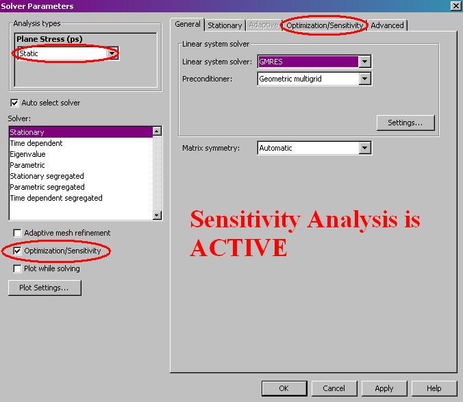

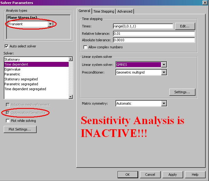

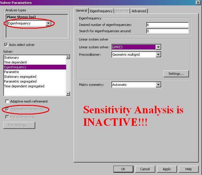

Basically, my problem is that when I choose one of the "time dependent" or "eigenfrequency" solvers in solver parameters, the "optimization" tab gets turned off. Therefore, I cannot arrange any setting for "sensitivity analysis" and hence cannot use "sensitivity analysis" in combination with "eigenfrequency" or "time dependent" solvers. Please see the attached pictures, which are some screenshots from solver parameters.
Anyway, as for your question I should say my problem at hand is an eigenfrequency analysis depending on a geometrical dimension.
Do you think if there is any way that I can have "sensitivity tab" active while using "eigenfrequency" or "transient" solver?
Many thanks,
Masoud
I have a same problem.
for me that means you need to run it via matlab, as the sensitivity "loops" are not programmed into the GUI for eigenfrequencies, its like adding prestressed eigenfrequency analysis, you MUST go via matlab in v3.5, but no longer in v4 :)
