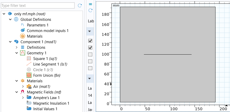

Hello everyone, I have a problem and hope that someone can help me. I have attached a video and an image. The video shows (in blue) the trend of the y-component of the magnetic field traveling on a tape of HTS (in orange).
In Matlab, I reproduced this trend, and the function for By is "waveform = A * sin(2pix/lambda - 2pift) + DC_offset" with A = 0.68 [T], f = 12 Hz, lambda = 42 mm, DC_offset = 0.68 [T], mu_0 = 1.2510^-6 [H/m].
I would like to reproduce this phenomenon in Comsol, so I defined a 2D geometry (shown in the image) that consists of a tape of 92 mm modeled as a line and an external square space defined as air; the shape of this space is not important. I need to use the magnetic field physics in Comsol. I tried applying this function directly as an external magnetic field on the tape, but Comsol does not allow it. So my question is: How can I define and where can I apply the "waveform" function, variable with space and time, which synthesizes By so that it directly affects the tape and therefore reproduces something similar reported in the video?

The problem is that I can't apply this function, as a magnetic field, directly on the tape line. The external magnetic field condition in mf physics is only applicable at the boundary of the geometry but I need to impose in this trend of By on my line.

this may be a case for a pointwise constraint: The constraint expression mf.By - yourFunction may do the trick.

Here is a small model I used to test it. Look into the pointwise constraint. Here the expression is mf.By - 1, which forces a By component of 1 T on the line. Replace the '1' by your function and the space and time dependent values of the function should be forced on the line.

Thanks so much Edgar this is just what I needed to complete my model! You have been very kind.
