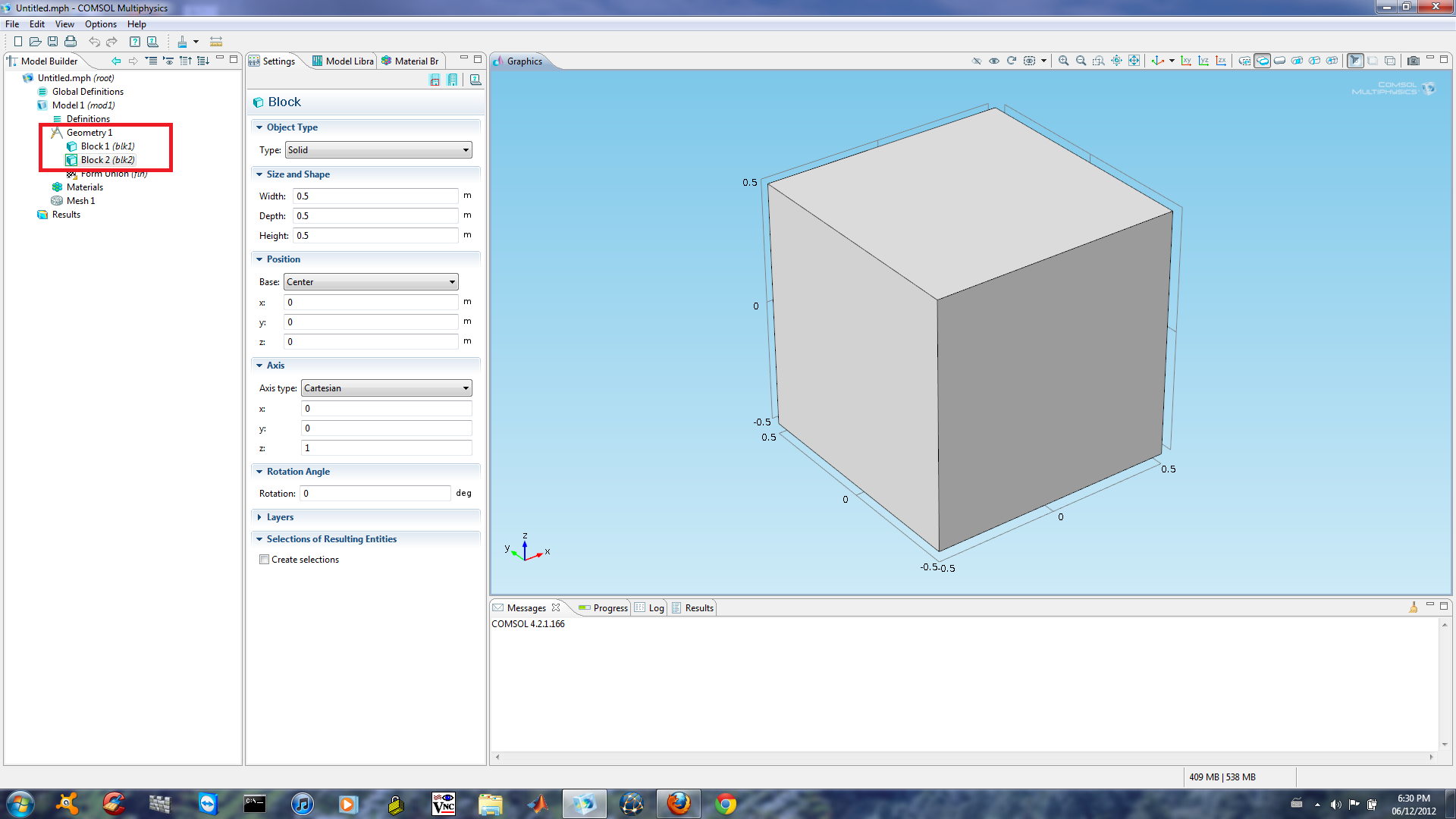

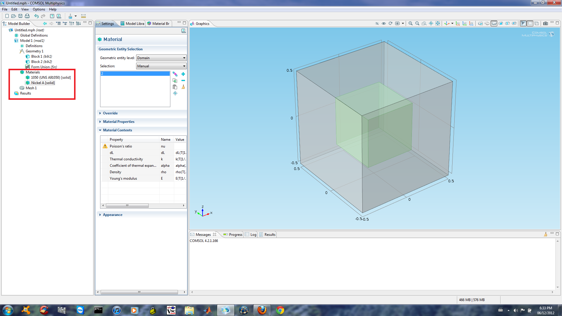

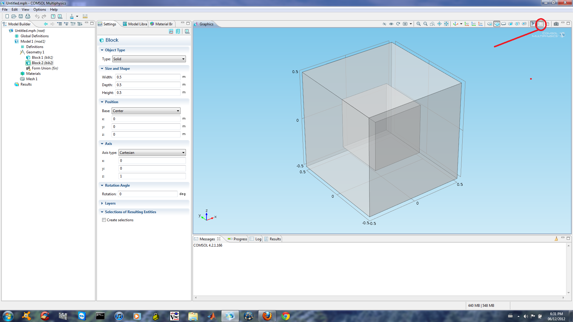

attached find the image files of the model. First create two blocks of different size (_1), then go to transparent option (_2), go to material and select the materials that you want and define them under domains selecting any domain (block) you want (_3).
cheers
Mayur
cheers
Mayur

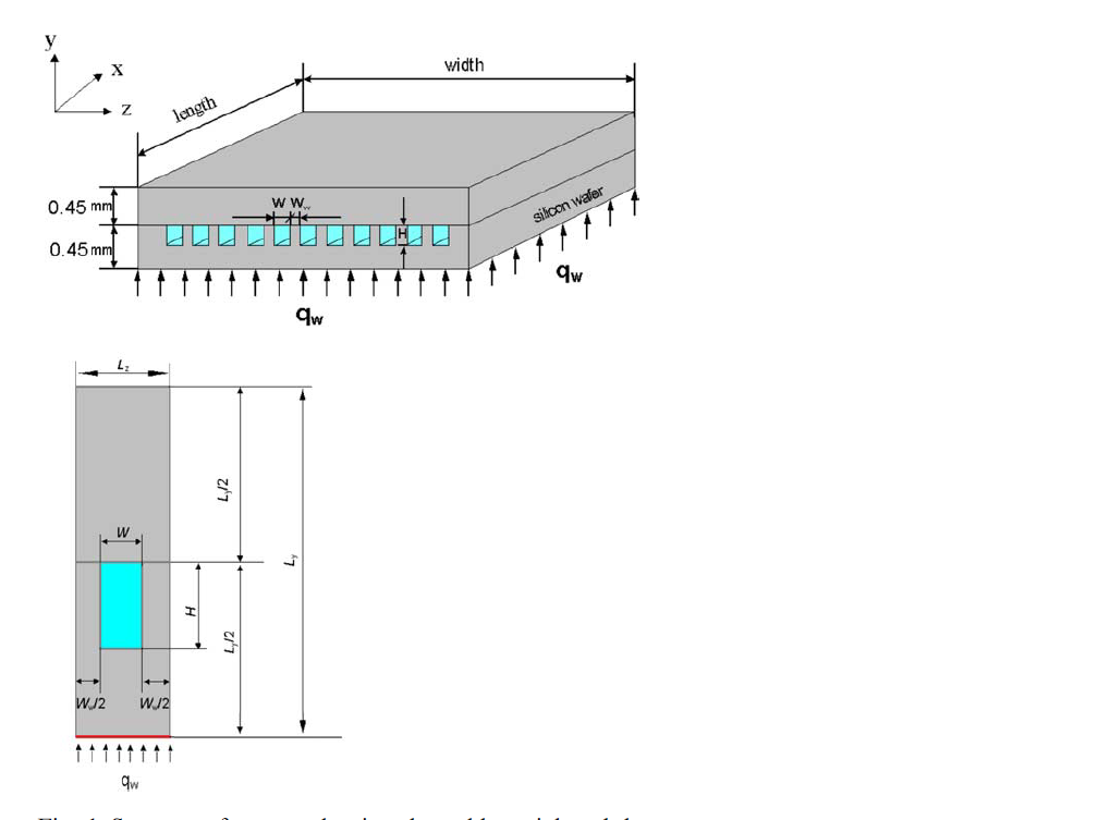

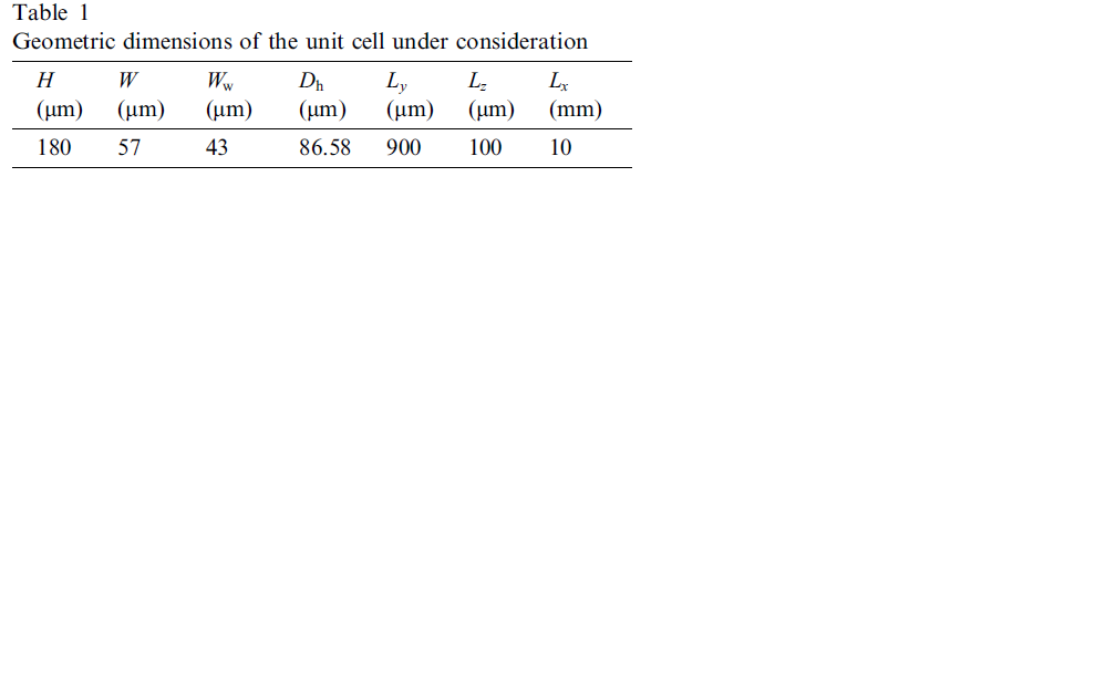

                                                Posted:
                                1 decade ago
                                7 dic 2012, 19:07 GMT-5
                                                    Hi Mayur,
I tried in the way you defined the geometry for 3D. It is really helpful for my understanding.
But Still the geometry what i was planning to desing has dimebsion
100X900X10000
Where each heat sink has dimension 57X180X10000
and there is equal length from each node in X-direction.
I am attaching the geometry of what I am trying to design with this. Where actually sink is somwhere inside the channel and not exactly at the base how you defined in the model.
So I think I have to use boolean operator.
But When I am using boolean operator some of the surface creates like " over ridden"
Thanks again,
Purvi
                            Hi Mayur,
100X900X10000
Thanks again,
Purvi

                                                    are you trying to replicate the result published in International Journal of Heat and Mass Transfer 47 (2004) 4215–423?
                                                Posted:
                                1 decade ago
                                7 dic 2012, 20:59 GMT-5
                                                    Yes, I am trying to use this geometry for my practice.
                                                Posted:
                                1 decade ago
                                7 dic 2012, 21:00 GMT-5
                                                    I mean same geometry of International Journal of Heat and Mass Transfer 47 (2004) 4215–423?
                                                Posted:
                                1 decade ago
                                7 dic 2012, 21:12 GMT-5
                                                    okay, after looking at this paper, it seems water is flowing through the cyan color channel (Fig 1 and 2 in paper), actually you tried exactly opposite to what is given in the paper.
                                                Posted:
                                1 decade ago
                                7 dic 2012, 21:36 GMT-5
                                                    Yes I think You are write in this channels are inside containing water.
My basic problem is defining geometry
