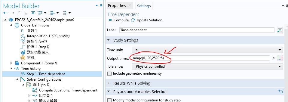

Hi Guys,
What I intended to do is 1: First run a short time dependent study to make sure everything works OK in the time dependent study setting. This is already done. And Comsol shall already have a good solution for the whole setup. (This one step took 3h to finish.) 2: Increase the time steps setting in the solver and use the "Update Solution". Now I expect the time dependent study will only need to calculate the value for the increased time steps instead of solving for everything.

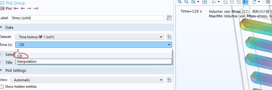

But when I tried this, it seems the "Update solution" did nothing. At least in the resuts, the time steps results are still the same as the before.
I am wondering if there is some setting I did wrong in this case, or I misunderstood the functionality of "Update Solution". Could you help me if you encoutered something like this before?
