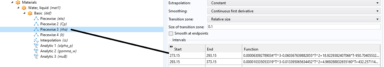

I am practicing the moisture transport in porous medium. I would like to know the formulation of liquid density of water in comsol. I have seen that the table in density of liquid water which shows mt.hporous1.lw1.frho_w(mt.Trho). It means that the density of liquid water is a function of temperature. But I cannot find the exact formulation in comsol about this function frho_w(Temp).

See attached pic.
