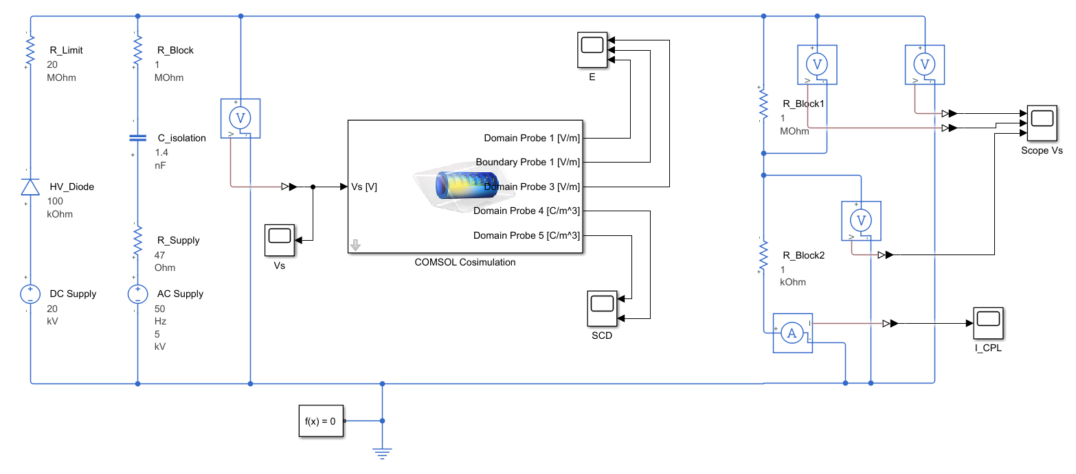

Hi, I just need some advise on the model I built below. Is there anything wrong with the connection? My plan is to see the current flowing through the comsol model and also the resistors branch when I change electrical conductivity of my electrical tree. The comsol model is a needle-plane dieletric 3D model with an electrical tree.
I have no idea how to connect the ammeter to the comsol block to monitor it's current so I just put one across the resistors branch.
I noticed that no changes to the current eventhough I changed the conductivity of my tree in comsol. I used the electrical current study to reflect the conductivity changes.
So can someone advise what correction i should make to my simscape circuit.
Thanks.
