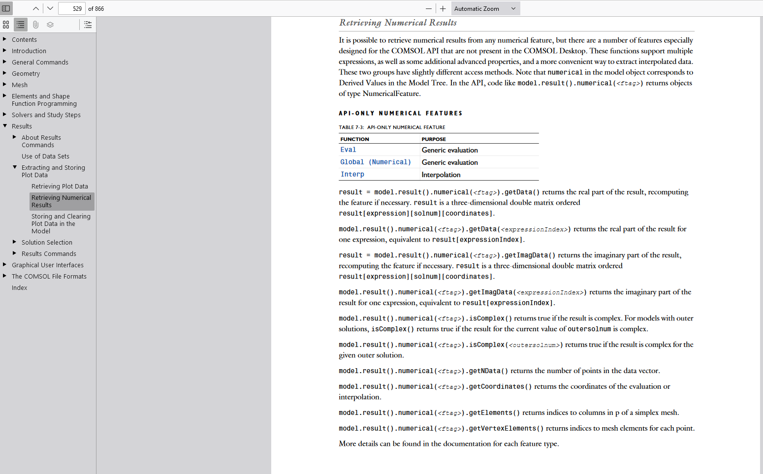

You can use the Interp numerical evaluation feature, see page 529 in your first link to the documentation. I think that this is what the mphinterp MATLAB function does.
