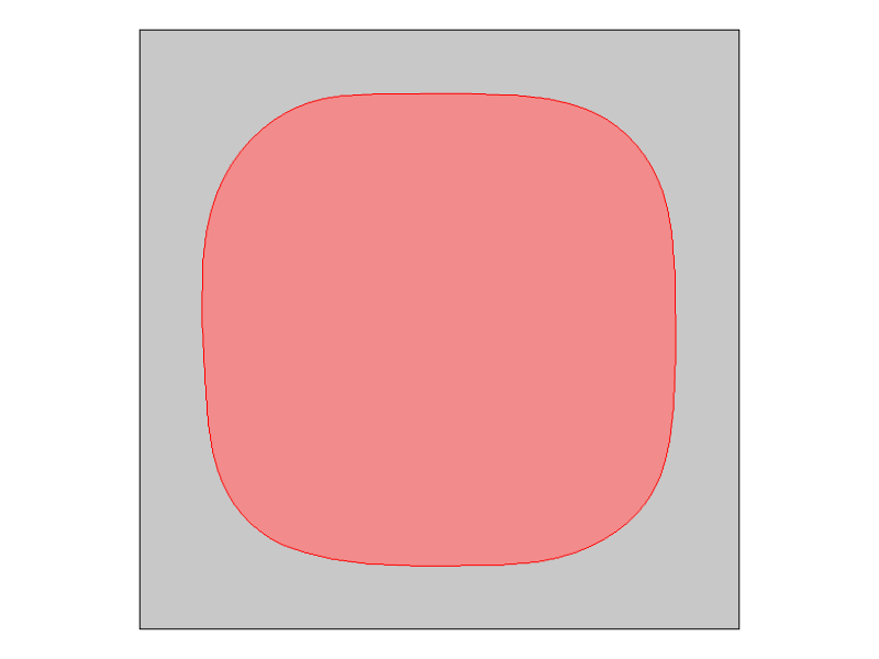

It is possible to use contour plots as geometric entities with the following steps:
1. Create a contour plot with a single contour.
2. Add it as a Plot data node under Export.
3. Export the contour data to a text file as a Contour plot with the Sectionwise data format.
4. Add an Interpolation Curve node to the Geometry sequence.
5. In the Interpolation Curve settings, use File as the Data source and Sectionwise as the Data format, and browse to the exported contour data file. Click Build Selected to see the curve. You may need to adjust the Relative tolerance setting to get a smooth curve.
6. When the geometry is rebuilt, the curve is included.
You can add several contours by exporting the data for each curve and adding Interpolation Curve nodes for each contour.
I have attached an image of an interpolation curve for a simple example, using a contour for a level of the solution to Poisson's equation on a square.
Magnus Ringh, COMSOL

Hi Magnus
Thanks, indeed in 2D it looks simple but not straighforward though, many manual steps, not really to be done for ten models per hours ;) But still thanks for the tip.
What about 2D, the same way with slice plots ?
Hi Magnus
