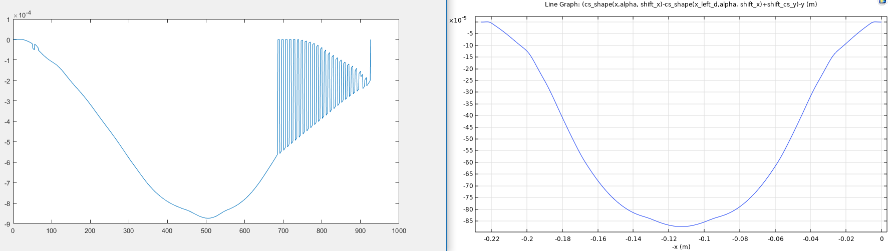

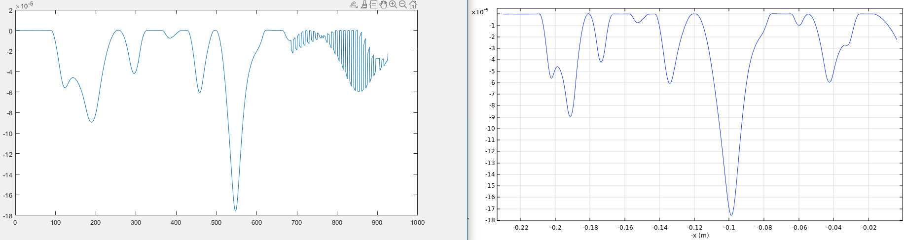

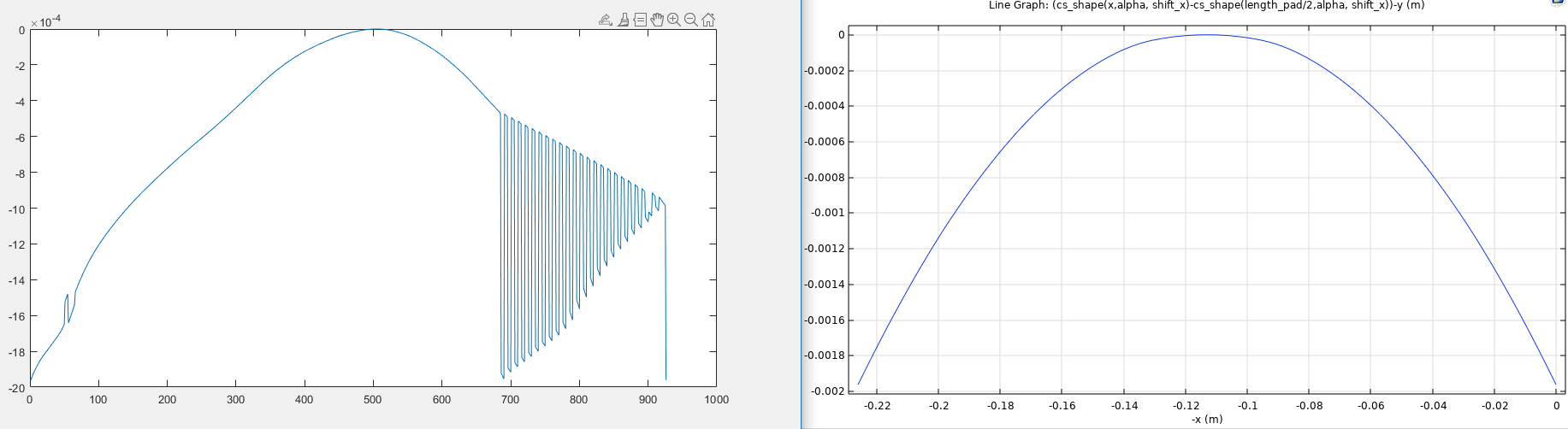

When extracting the data points of a line plot from COMSOL with something like: data = mphplot(model,'pg37'); y_data_plot = data{1,1}{1,1}.d; I get this weird 'noise' in my data which can be seen in the Matlab plot. The attached pictures show the problem. This is a problem for my post processing as I need to determine the local maxima/minima. It seems like a numerical issue but I don't know how. Has someone seen this behavior before?
To give some background, I perform a contact study where a structure is pushed against a counter surface. The plots show the distance between the deformed configuration of the bottom domain of the structure and the counter surface.

Hi Lars,
thank you for the hint! I couldn't figure out how to plot it correctly with the simplex indices so below a workaround/solution which is easy and worked for me (for anyone encountering this in the future):
you can get the correct order of the y-data in Matlab by first sorting the x-data with: [x-data_sorted,order-x] = sort(x-data); and then sorting the y-data according to the order of the x-data with: y-data_sorted = y-data(order-x);
greetings, Helge
