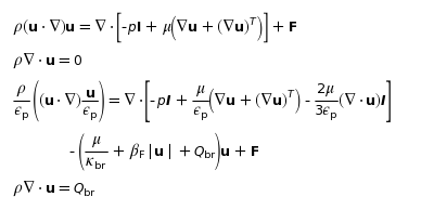

The momentum equations in the Brinkman Equations interface and the Free and Porous Media Flow interface have been corrected. The term -Qbr·u/εp2 in the right hand side previously lacked the factor 1/εp2 , where εp is the porosity.
I have attached COMSOL 4.2 equation.Is the equation correct and how to correct,if not?
