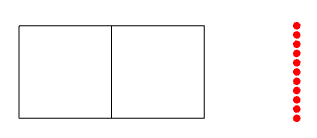

Below is a picture that ilustrates an example model. The red dots illustrate my light source.
