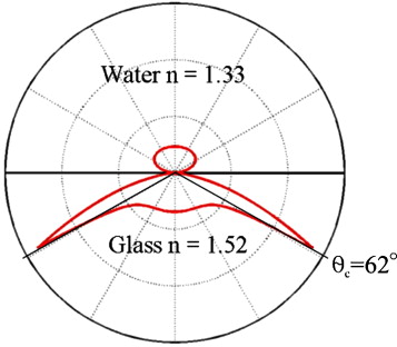

I am trying to reproduce far field radiation patterns for single emitters close to an infinite dielectric interface. Namely, I place an emitter in air, in the vicinity of a glass substrate (10[nm] above). The dipole moment is oriented toward the interface.

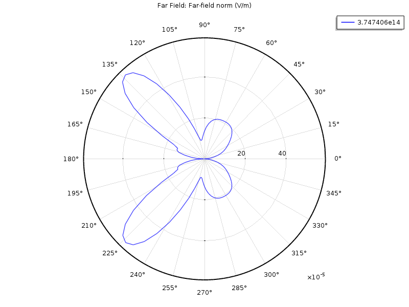

I expect a far field angular pattern similar to the one attached (expected_behavior.jpg where they put the dipole in water instead of air). Instead I get something like the other picture (dipole_near_interface.png).
Light should be directed along the critical angle (in Air/Glass case -> 41 degrees). Instead of that, I find an extremum at around 50 degrees.
I define the dipole as a point dipole. I have PML, but I guess that have two different materials touching could be a problem here. Therefore i want to know if I am indeed limited to finite systems, or if I can model a dipole with two infinite materials .

The dipole orientation in the file you uploaded is (0,0,1). A dipole pointing to the Z direction will not radiate in the Z direction. In order to get the "expected behavior" just change the dipole orientation to any (x,y,0), (1,0,0) for example.
I'm sure it's no longer relevant for you, but for other people (like me) who are looking for advice, it might help.
