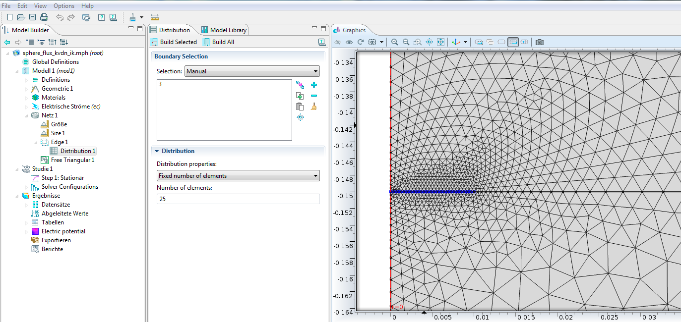

I built and computed your model and receive almost identical values for current flow through the outer sphere (3.14e-4 A and 3.15e-4 A, respectively). This is in the tolerable range of numerical inaccuracy, taking into consideration that it was just my first try.
Besides there is a general problem of inaccuracy when computing fluxes through boundarys, see www.comsol.com/support/knowledgebase/973/.
Because the file size was too big to attach the model, I created another one in 2d axisymmetric mode. The result is similar. Check it out and ask if something isn't clear.
I built and computed your model and receive almost identical values for current flow through the outer sphere (3.14e-4 A and 3.15e-4 A, respectively). This is in the tolerable range of numerical inaccuracy, taking into consideration that it was just my first try. Besides there is a general problem of inaccuracy when computing fluxes through boundarys, see http://www.comsol.com/support/knowledgebase/973/. Because the file size was too big to attach the model, I created another one in 2d axisymmetric mode. The result is similar. Check it out and ask if something isn't clear.

by playing a little with the mesh I get a current density (integrated over the 2*pi*r loop) of
Normal current density (A) GND Normal current density (A) Electric potential
-3.59484e-4 3.2505e-4
over the external sphere edge and the internal ring.
All with your 8e-6V potential, and a normal mesh on the external domain.
By further increasing the mesh along the Voltage edge I even get to 3.44e-4 (A) closer, still mesh sensitive
Now to get a far better Current value is to use a Terminal node,
then your Global evaluation - Terminal curent on the is 3.60202e-4 (A)
less than 1:3000 from the GND current with a fine mesh of -3.60346e-4 (A)
Have fun Comsoling

2 things:
1) certainly the mesh, your source region is small and you need several mesh elements along the edge and in the direct vicinity to calculate correctly the Voltage drop, hence the electric field, and from there the current flowing.
2) you have Electric Potential and lumped Terminal type BC to define a voltage or a current source. The Lumped Terminal BC automatically adds local flux (current) variables, that are resolved with higher precision than for the Electric Potential BC node. The latter allows you hovever, to define a voltage as function of the boundry length/area, or some spatially (not only time) variable Voltage or current source. But with a less precise flux evaluation.
When I say less precise, it's with respect to a coarse mesh, with relly fine mesh you get almost to the same values.
Last thing, as I have said several timeson the Forum, (you are not the first ;): consider the mesh as a sampling method, for music people today understand Nyquist criteria, and you decide sample with reasonably hgih speed, to get a good quality sound, for meshing it's the same, apart that it is the depedent variables, and particularly their gradients you should look at, if the variables have high gradients, steep slopes, you need dense mesh to resolve correctly the shape, else you make a triangular short cut and your results will be easily wrong
