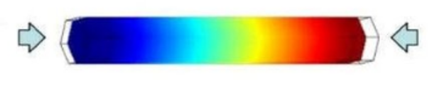

I am new to the Structural Mechanics module in COMSOL Multiphysics and I am facing difficulties in determining the appropriate constraints and loads for my simulation.
I would like to simulate the strain distribution along a compressed hexagonal cone. However, all the examples I have come across in the documentation involve fixing one end of the hexagonal shape.
In my case, I would like to apply compression to both the top and bottom of the hexagonal cone, as shown in the attached figures. I am wondering if there is a way to compress the object on its bottom and top sides without fixing one end.
I would greatly appreciate any help or advice on how to achieve this simulation setup.
Thank you in advance for your assistance.
