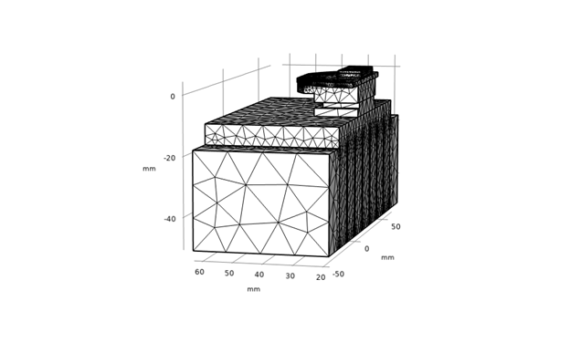

Attached is the file.
I tried to follow the example as shown below:
https://www.comsol.com/model/lumped-thermoelectric-module-with-pid-control-102421
I found that those nodes are on the fins of the heat sink. It seems that their temperatures quickly reach infinite and cause the problem. I have tried to use turbulant flow as well. It did not yield error but also did not converge. Since my model and the example look so similar, I could not figure out what made mine fail to work.
The major difference is that I only simulate half of my model by using symmetry.
Attached is the file. I tried to follow the example as shown below: https://www.comsol.com/model/lumped-thermoelectric-module-with-pid-control-102421 I found that those nodes are on the fins of the heat sink. It seems that their temperatures quickly reach infinite and cause the problem. I have tried to use turbulant flow as well. It did not yield error but also did not converge. Since my model and the example look so similar, I could not figure out what made mine fail to work. The major difference is that I only simulate half of my model by using symmetry.
Posted: 2 years ago 12 mag 2023, 15:57 GMT-4
Updated: 2 years ago 12 mag 2023, 16:00 GMT-4
That's not a simple model and I doubt I can address it all. But the first thing I notice is that your domain #4 "TEC_effective" doesn't seem to have any boundary specification on what must surely be a symmetry-plane face, and I don't see any physics assigned to that volume region either, although you have meshed that volume. (Usually, if you are deliberately not assigning physics to a volume in your model, then you wouldn't normally mesh that domain either.) Might these thoughts help/suggest part of your problem? Also, your mesh looks rather coarse to me, in a number of locations.
Posted: 2 years ago 12 mag 2023, 16:19 GMT-4
Updated: 2 years ago 12 mag 2023, 16:21 GMT-4
Sorry, that was some legacy from different trials. I used that domain with turbulent flow before, which did not give me good solution. Then I switched to lump model. I must have forgot the disable that domain.
PS. I tried to modefy the example by changing the number of fins from 8 to 18. It did not coverge any more. I think you may be right, the coarse mesh may cause the problem.
