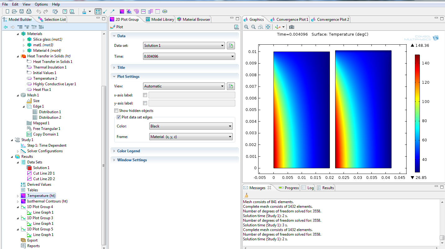

Hi Ivar,
Unfortunately, I can not open 4.3 file. However, I have attached 4.2a model that you can open. The temperature difference is significant.
Susant
Hi Ivar, Unfortunately, I can not open 4.3 file. However, I have attached 4.2a model that you can open. The temperature difference is significant. Regards, Susant
Posted: 1 decade ago 19 ott 2012, 23:14 CEST
indeed you see differences with your model, but
1) if you use the same material for the thin layer (and forget your "Copper")
2) if you use the same thickness !! you have a factor 1000 difference because of the units, geometry in [mm], highly condutive layer in [m] !
3) you use a same mesh density (copy the mesh from one domain to the other)
You will get far better results, almost identical
And anyhow if you use it in this direction (tangeant) then the anisotropy is not really relevant
Hi indeed you see differences with your model, but 1) if you use the same material for the thin layer (and forget your "Copper") 2) if you use the same thickness !! you have a factor 1000 difference because of the units, geometry in [mm], highly condutive layer in [m] ! 3) you use a same mesh density (copy the mesh from one domain to the other) You will get far better results, almost identical And anyhow if you use it in this direction (tangeant) then the anisotropy is not really relevant -- Good luck Ivar

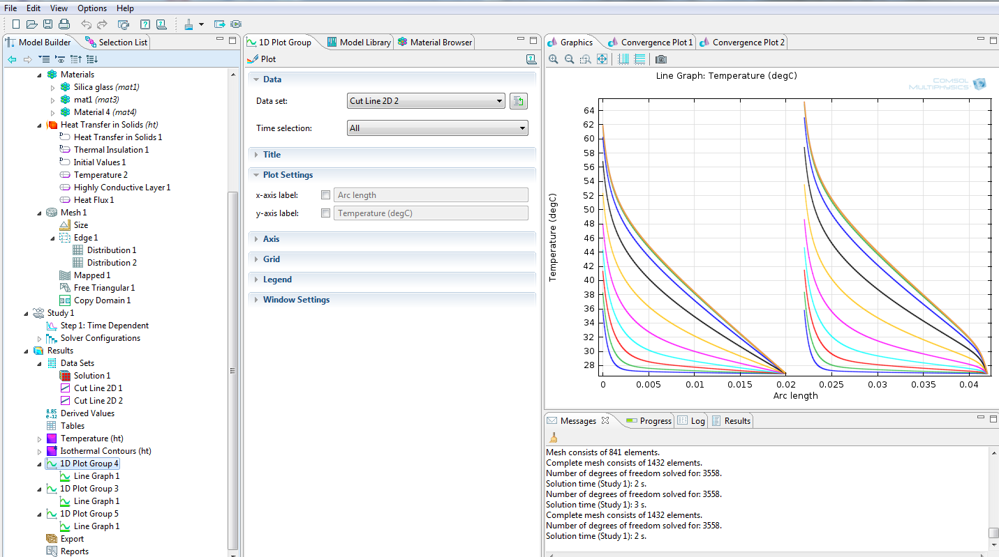

Hi Ivar,
Thanks! The layer dimension was at error. The results are quite close.
I noticed that you can plot both case studies on the same axis. How did you do that? I would appreciate if you can point me to the relevant document.
Susant
Hi Ivar, Thanks! The layer dimension was at error. The results are quite close. I noticed that you can plot both case studies on the same axis. How did you do that? I would appreciate if you can point me to the relevant document. Regards, Susant
Posted: 1 decade ago 20 ott 2012, 12:31 CEST
that is easy, when you select a line plot, and you select edges, by default COMSOL assumes these are joined as a long (poly-) line, if not, that means these are dsjoint, then the default "arc-length" for the horizontal axis cannot be defined.
You simply go the the horizontal axis tab of the line plot sub node and set in a user expression such as x, or r (in 2D-axi) or y,z ... even you can plot flux versus T temperature if that makes some sens (typically with table plots). Then your edgs might be fully disjoint.
Something similar happens too in 2D, i.e. the cut-surface data set ndes, you need sometimes to arange how to show the surface x,y in absolute or elative surface length values
Hi that is easy, when you select a line plot, and you select edges, by default COMSOL assumes these are joined as a long (poly-) line, if not, that means these are dsjoint, then the default "arc-length" for the horizontal axis cannot be defined. You simply go the the horizontal axis tab of the line plot sub node and set in a user expression such as x, or r (in 2D-axi) or y,z ... even you can plot flux versus T temperature if that makes some sens (typically with table plots). Then your edgs might be fully disjoint. Something similar happens too in 2D, i.e. the cut-surface data set ndes, you need sometimes to arange how to show the surface x,y in absolute or elative surface length values -- Good luck Ivar
