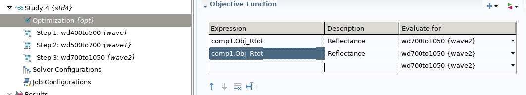

I am trying to run an optimization on my optical structure, where my objective function is calculated from separate study steps each for an interval in the wavelength domain. The reson I want to have separate study steps is that meshing required for the lower wavelengths is too fine for the higher wavelengths and the simulation already takes too long, so I try to make the computation less expensive. So, please let me know if you have a better solution for this. The problem here is when I add multiple wavelength domain steps under the optimization node (see screenshot), I can not choose them in the objective function section of the optimization node, as it only shows the last wavelength domain step in the "Evaluate for" menu. Is there a way to do this in COMSOL?
PS. my version of COMSOL is v5.4.
