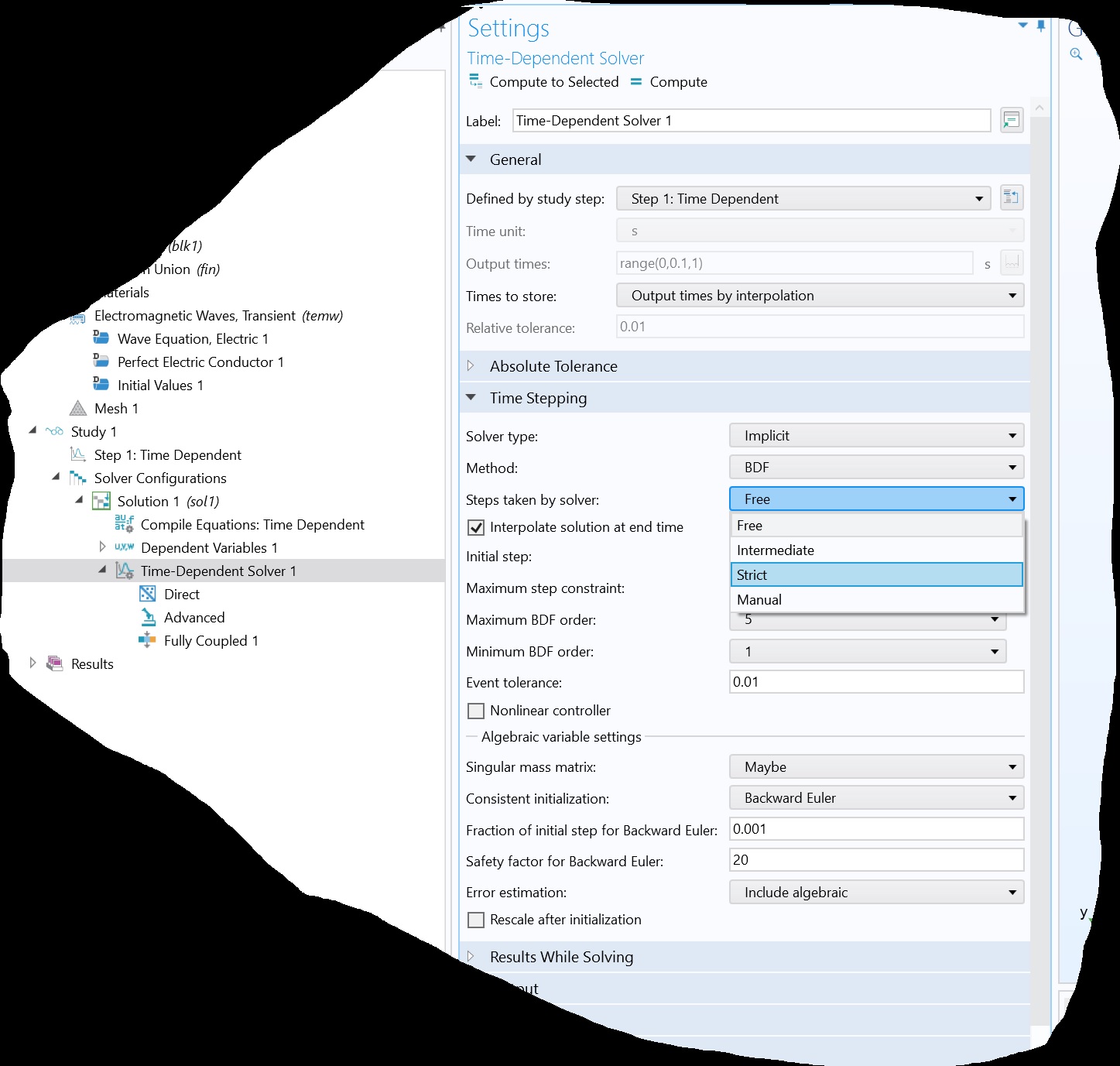

Thank you.But I do not konw how to choose the "manual" option for my time stepping, and Where to choose strict?

Thank you. My voltage is the AC signal, the sin function,V=50sin(2pi200t), and the viscosity of the fluid is the e index,0.05823+(1.27386-0.05823)*exp(-t[1/s]/23.022). Both functions contain time. The specific details of the time step are not very clear.
>I have done a similar thing to what Robert describes. Also note that you can apply a function to the step values. This makes it possible, for example, to have steps that depend exponentially on time, useful if you have some process that is roughly logarithmic in time. > >Be sure to use Strict stepping. Thank you. My voltage is the AC signal, the sin function,V=50*sin(2*pi*200*t), and the viscosity of the fluid is the e index,0.05823+(1.27386-0.05823)*exp(-t[1/s]/23.022). Both functions contain time. The specific details of the time step are not very clear.
Posted: 2 years ago 4 mar 2023, 17:18 CET
I've attached a picture. This example is unrelated to fluid dynamics, so do not assume any other settings shown apply in your case. Anyway, I encourage you to study Comsol's provided application examples and familiarize yourself with the best settings for various time-domain problems of relevance to you.
