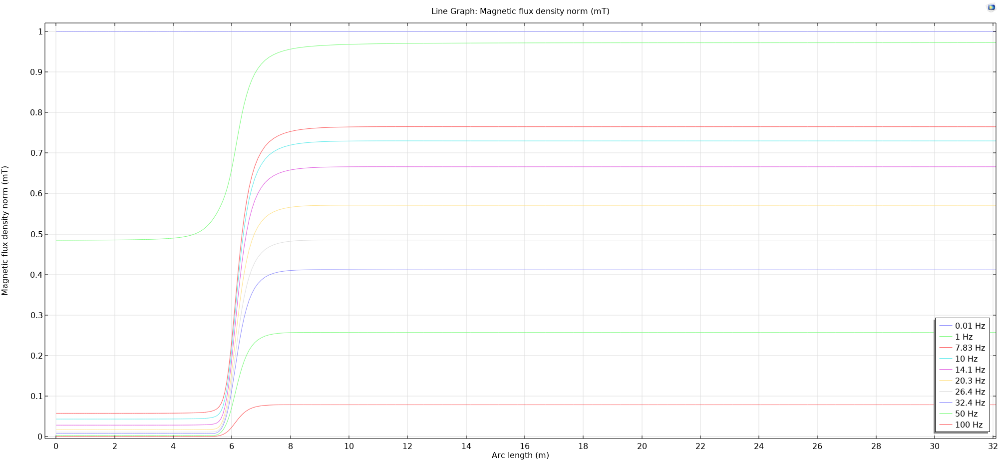

Then I implemented an aluminum tube with much larger dimensions: external radius of rCyl=0.6 m, 2 cm thickness and length of 12 m. For such a geometry, I have to modified the meshiing phase a bit. I look at results for the real and imaginary parts of the Br and Bz components as well as the field modulus along the tube axis and a generatrix located at 1.17x rCyl, i.e. outside the tube. As in the case of the short copper tube, I am expecting the field to become again 10 mT at some z away from the tube. Unfortunately, I obtain field which plateau at some values at large z, but do not reach the background field value as shown for B modulus on the attached plot.

Hi Gilles,
you assigned a conductivity of 5000 S/m to the air domain.
Cheers Edgar
