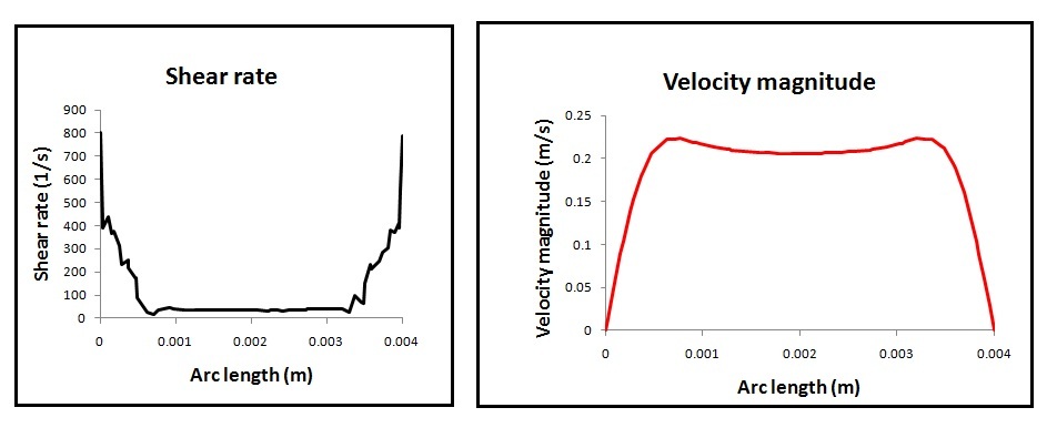

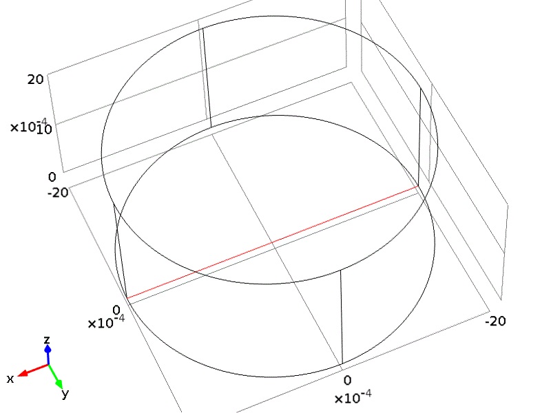

By simulating fluid flow through an ideal 3D cylinder (inlet constant normal velocity: 0.175 m/s; outlet constant pressure= 0Pa), the result was plot from a cut line at the outlet, across the circle center (as attached).
It is noted that velocity magntiude is symmetrical along the line (left and right side of the line), however the shear rate is slightly asymmetry in the result.
May i know why this happened? I thought both velocity magnitude and shear rate (velocity gradient) should be symmetry? Is this caused by numerical error?

Thanks Nagi. Attached are the result plot of velocity magnitude and shear rate.

The shear rate plot looks close enough to symmetric given the element size. I am guessing your element size from the lengths of the straight segments in the plot you provided!
A degree of freedom is an unknown that you solve for. For fluid flow problems it would be velocities and pressures. The shear rate is the magnitude of the gradient of the velocity (so it’s a first order derivative Ivar). That makes it less accurate than the velocities themselves.
To answer your second question, yes higher accuracy results from the increased number of nodes (and degrees of freedom). If you had a symmetric mesh the results should have been symmetric, however a free tetrahedral mesh is not going to be a symmetric one.
